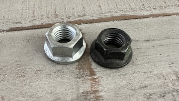

Hey guys,
I installed new Bilstein 5100s at .85 and FJ cruiser springs on my front, basically replacing the exact same setup I already have. I also purchased KYB mounts kits as well to replace the shock hats. The nuts they provide are 15mm. My old ones were 14mm, and I have a fancy 14mm ratchet which helps me get the single one in the back, so I just reused those.
As I was cleaning up, I found an extra bolt, which looks like one of the 3 bolts on the hat that secure the shock assembly to the car. I had my toolbox out and tools all over the floor, but I have a really hard time believing I randomly had a 14mm nut on the floor, that looks exactly like one of the 6 I pulled off the old suspension. I verified like 12 times that each of my shock assemblies have all 3 nuts fastened. I've. gone over everything a couple times, and nothing looks out of place.
Any ideas on where else this could come from? Left is 15mm supplied by KYB, and right is 14mm supplied either by last KYB kit, or stock Toyota.

There is also the nut that holds the strut shock on the shock mount in the middle. So one in the middle and three around the shock mount through the frame

Definitely not the middle one! That one is a little beefier
