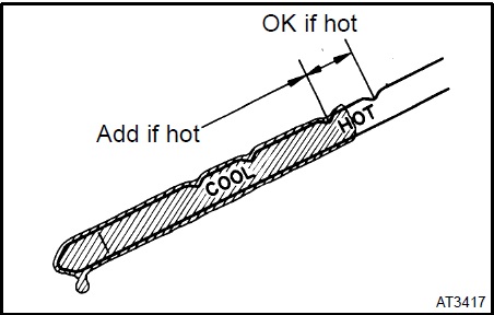

It doesn't matter if you have an external cooler or not, the procedure is the same.
Get fluid up to 160-180 degrees.
Park on level ground and with foot on brake and motor running put gear selector into each gear and back into park.
With engine running pull dipstick out and wipe it clean.
Reinsert dipstick fully for a couple of seconds and recheck it.
Fluid should be between the Hot indents.
All this is correct. If you are having trouble telling the difference between the actual level and extra fluid smeared up the dipstick, use a paper/shop towel like this:
That's my Odyssey dipstick, but the same idea applies. Wrap it carefully around, then open it back up without moving/sliding the paper towel. The dark line is the top of the fluid and all the wispy bits that are confusing won't show up strongly. The image above the dot for low fluid (it was still cold for that reading).
