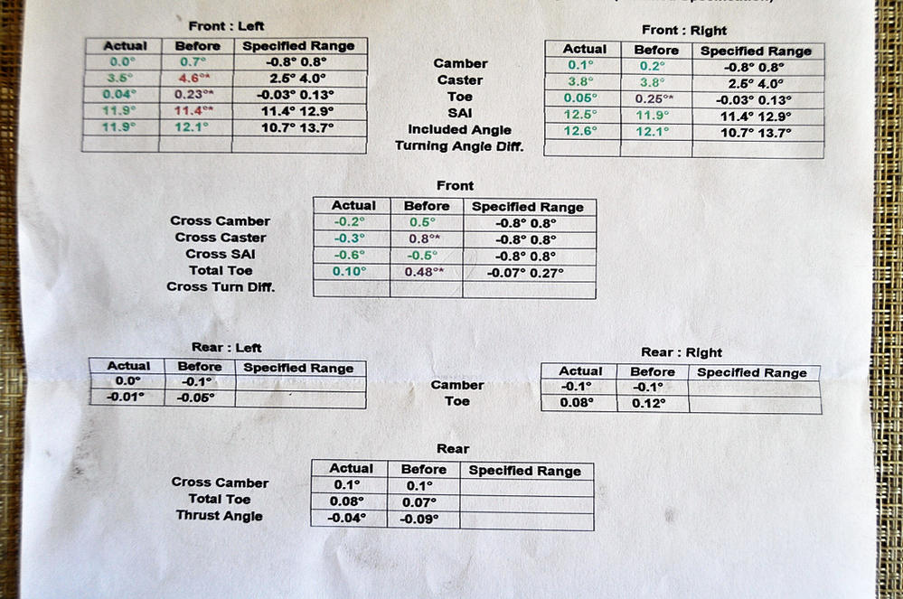

Just had my truck aligned today. All the adjustments were in the bottom eccentric bolts in the LCA's and the tie rods.
You can see where I was at before ,Camber and caster pretty close and I knew my toe was off since I changed UCA's last week and didn't mess with the tie rod adjustments. I wanted to get caster on the higher end to move the wheels forward so they wouldn't rub the mudflaps as much in the rear of the wheel well. Rides great now!
Here's my alignment specs.....
