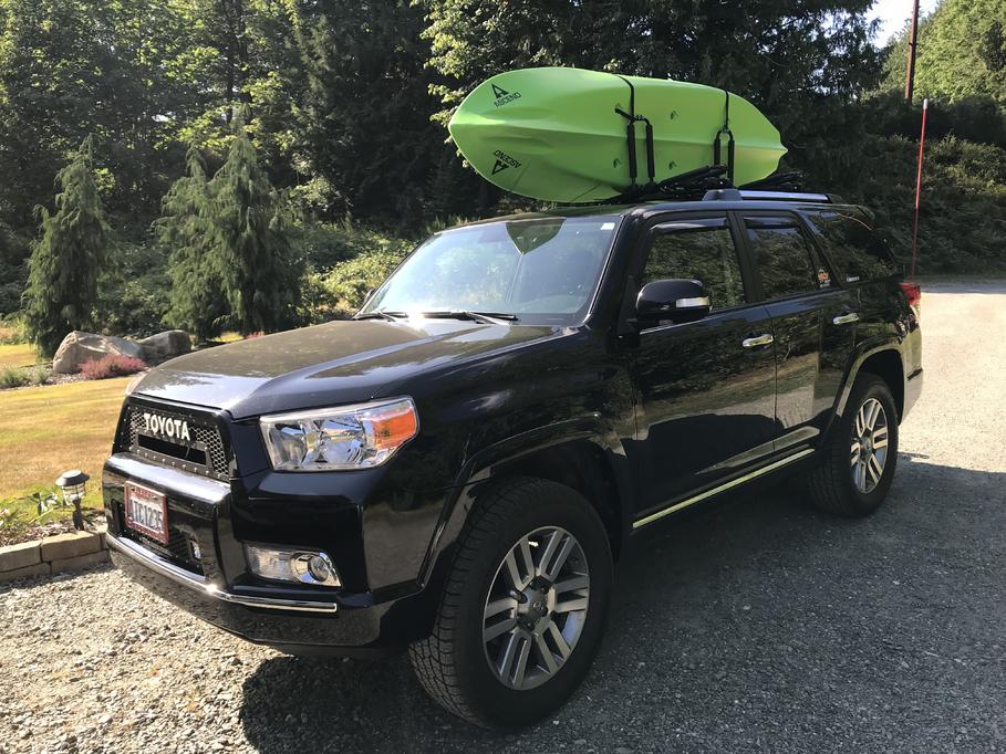

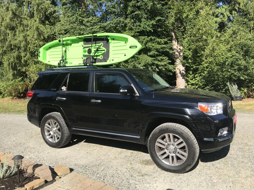

I swap the '10-'13 trail rack onto the '15 to keep it with the fleet. Couple inches higher than the buick style rack that is currently on the runners.

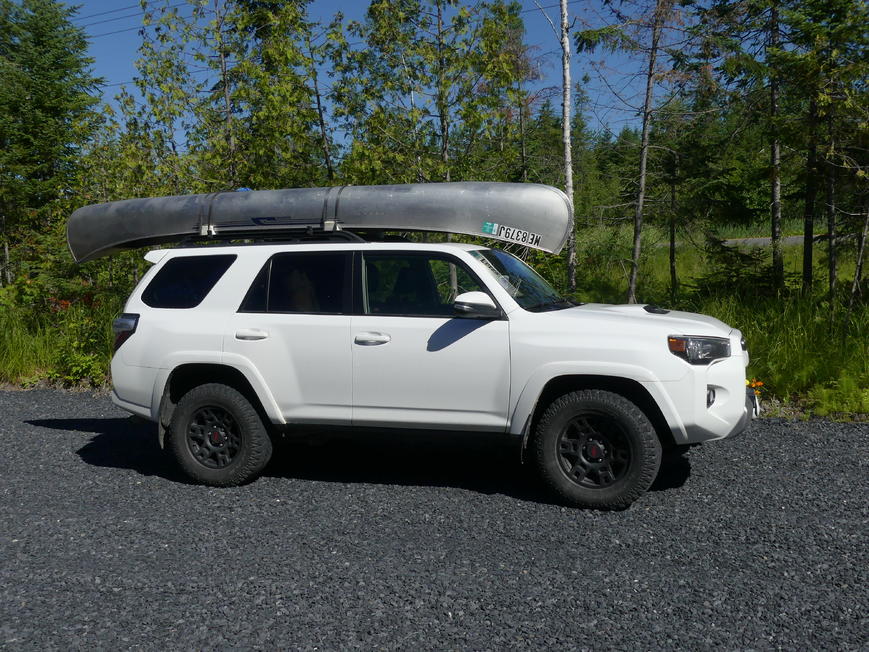

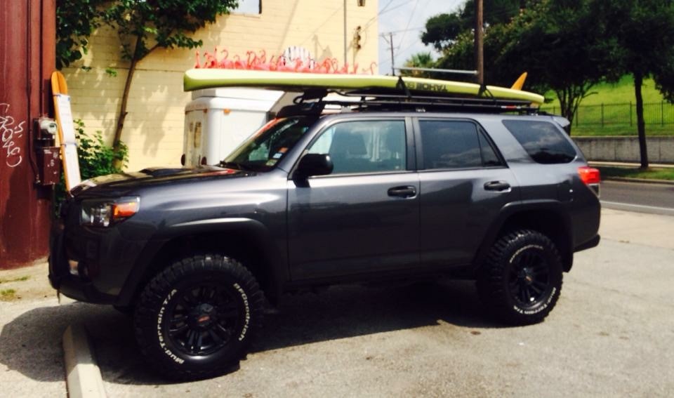

Just got this ascend t10, the other racks are for my ladies sup
