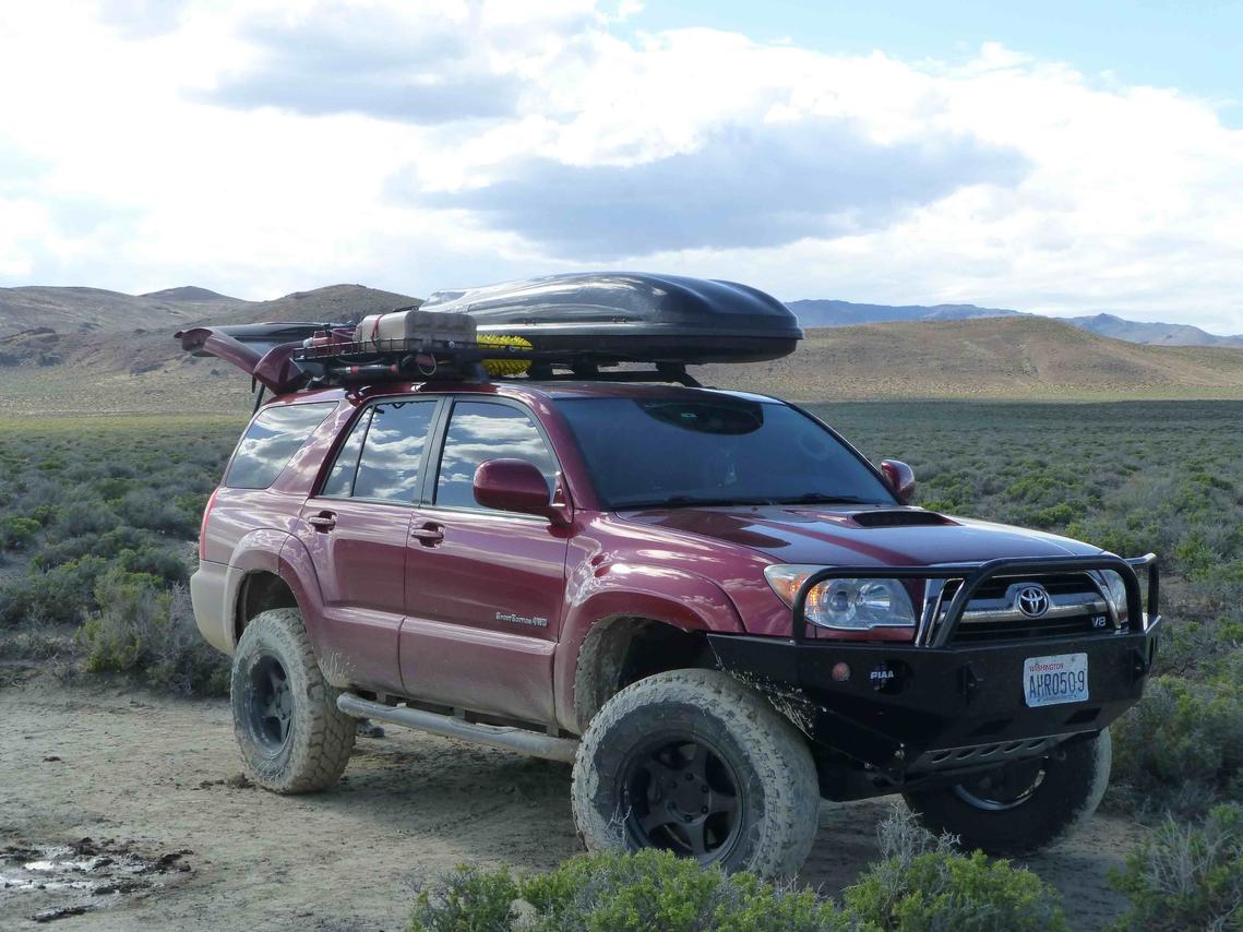

I currently use a Thule box for certain items and then with the help of 3 Thule cross bars and a modified Yakima basketcase carry my shovel, TRED 800, 20L Scepter MWC and kolpin fuel container (pic attached). I am looking to upgrade for more room on the roof and higher load capacity, but not looking to use RTT. Both can be modified to have a set of Thule bars mounted so I can use my cargo box and both have lots of mounting options.
I am leaning towards the K9 for the increased length but worried about regretting covering up my moonroof. I don't drive with it open all that much but do like the extra light that it lets in. Anyone regret having a full length rack over their moonroof?

My opinion is based solely on internet window shopping but I would go with the K9 rack. I like the longer length mainly. I don't ever use my sunroof so covering that up is no concern to me.
if your still interested, Frontrunner, I have one on the FJ80 and we use it and it works well and has handled abuse well. Keep in mind if something were to come loose Frontrunner rails go side to side not front to back...
