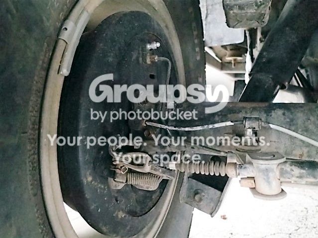

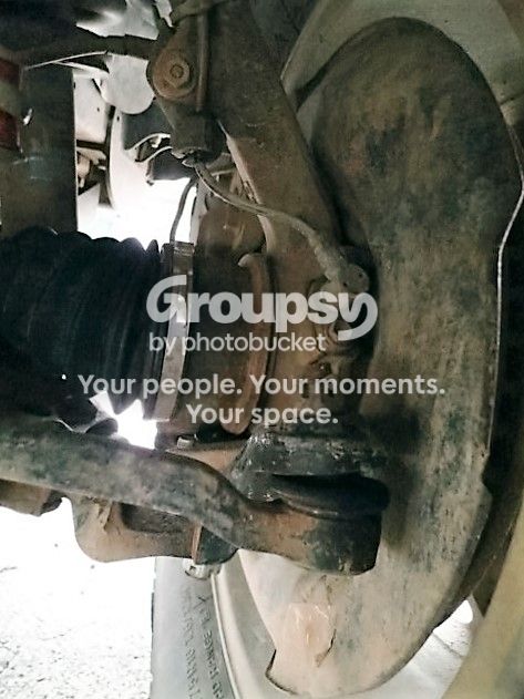

Can you post a picture of the ABS sensor you're trying to take off? I'm pretty sure my front right sensor is broken off and I'd like to replace that eventually.
Front (shown: right side) on the backside of the spindle above the lower ball joint with sheathed wire going to it and bolt just below it....
P1118882_zps46vtqhf2.jpg~original
The connector for it is on the frame towards the front of the truck a little in front of the wheel, makes it pretty easy to replace other than getting the wire off its keepers as it heads towards and then down the spindle.
Rear (shown: left side) on the backside of the axle next to the backing plate above the bell crank with sheathed wire going to it and also held on by bolt on an ear.
P1118883_zpslufdzeij.jpg~original

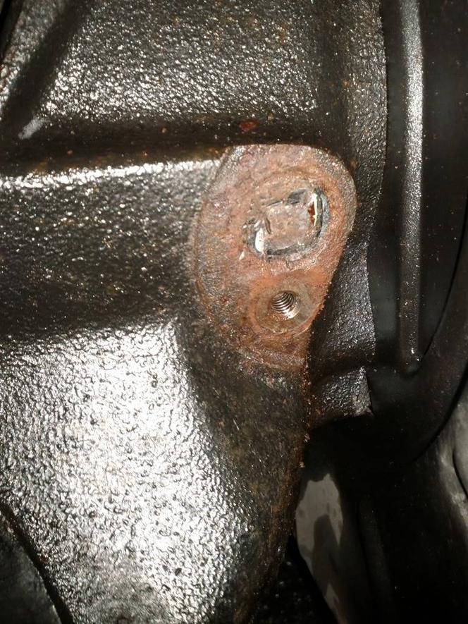

Went to replace my ABS sensor and it was broken. Now the portion that goes into the hub is stuck. Any tips on how to remove that without doing any damage?
There's a slot that allows you to fit the tip of a flat tip screwdriver between the sensor and the front knuckle or the rear axle housing. Insert the tip of the screwdriver and twist to start prying the sensor out. Once you get some movement, it will come out. There's a rubber seal around the sensor to keep moisture from getting in via the sensor hole and that's what causes the resistance from getting it out easy.
Sorry, i must not have been clear in my question. The wheel speed sensor broke into two pieces when I was removing it. So now the piece that goes into the hub is stuck and sheared off. Not moving.
Look like this (not my picture but same issue)
^Well that sucks.....
At this point, it's going to be difficult to get that out. If I had to do it, I'd very carefully start drilling it out and hopefully not screw up the ABS tone ring or the housing.
If you can punch a couple holes through it, hopefully you can start chiseling away at it and knock it loose.
Ideally if you can get it loose so you can pull it out with a needle nose pliers, that would be best.
Good luck, you're gonna need it..
The core is ferrous metal, I think. I would try bashing it with a drift pin, just to try to get it to move a millimeter. Then drill a hole and try using an easy-out. Pull the other side sensor to set the safe depth you can drill to; you don't want to go through. Put tape on the drill bit to mark the safe depth. If you can get the ez-out to turn, soak it with PB blaster, turn it some more, then pull with Vise-Grips. If it won't budge, you can try some heat--the outside is plastic and getting it soft might help, too.
I've never done this, but it's what I'd try.
