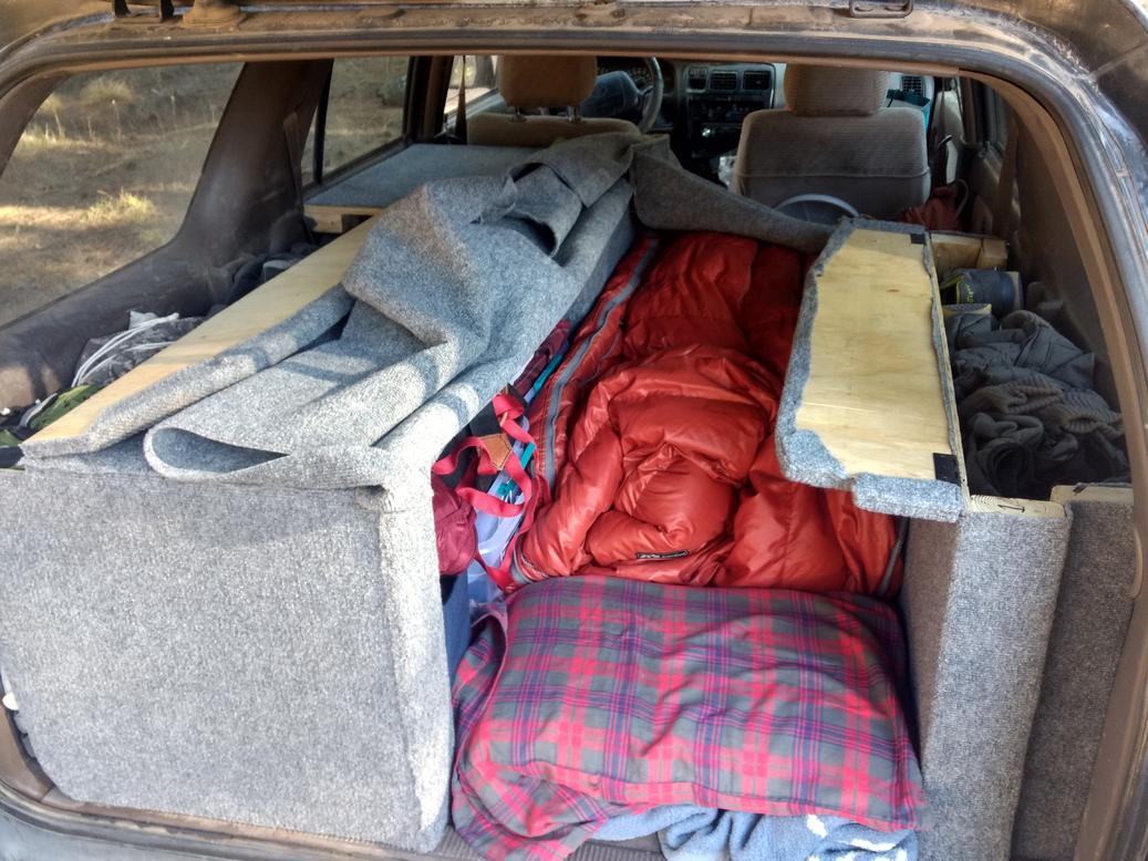

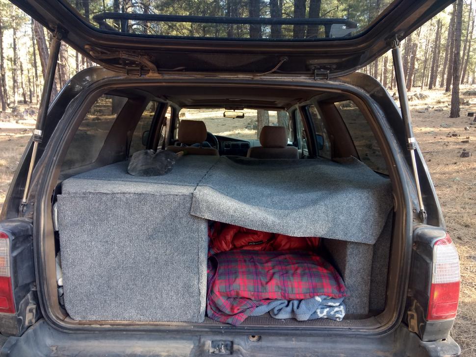

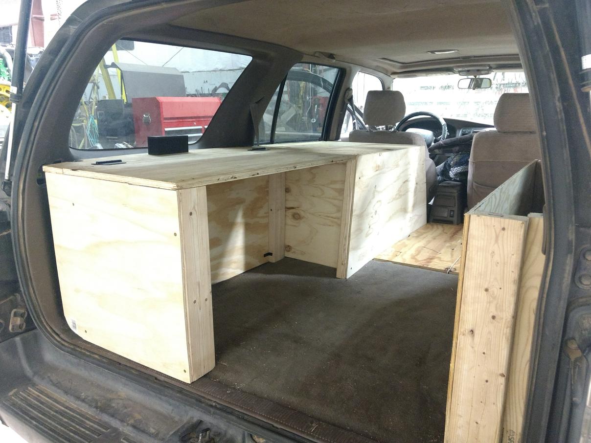

I took out the back seats and built two bins along the sides and a platform to level out where the seats were, all out of plywood and 2x4s. Then stapled carpeting to it, and used the d-rings already on the floorboard to tie them down. I'm 6'3 and I can lay flat on my back in between. The carpet goes across to velcro so that everything is hidden from anyone curious to look inside.

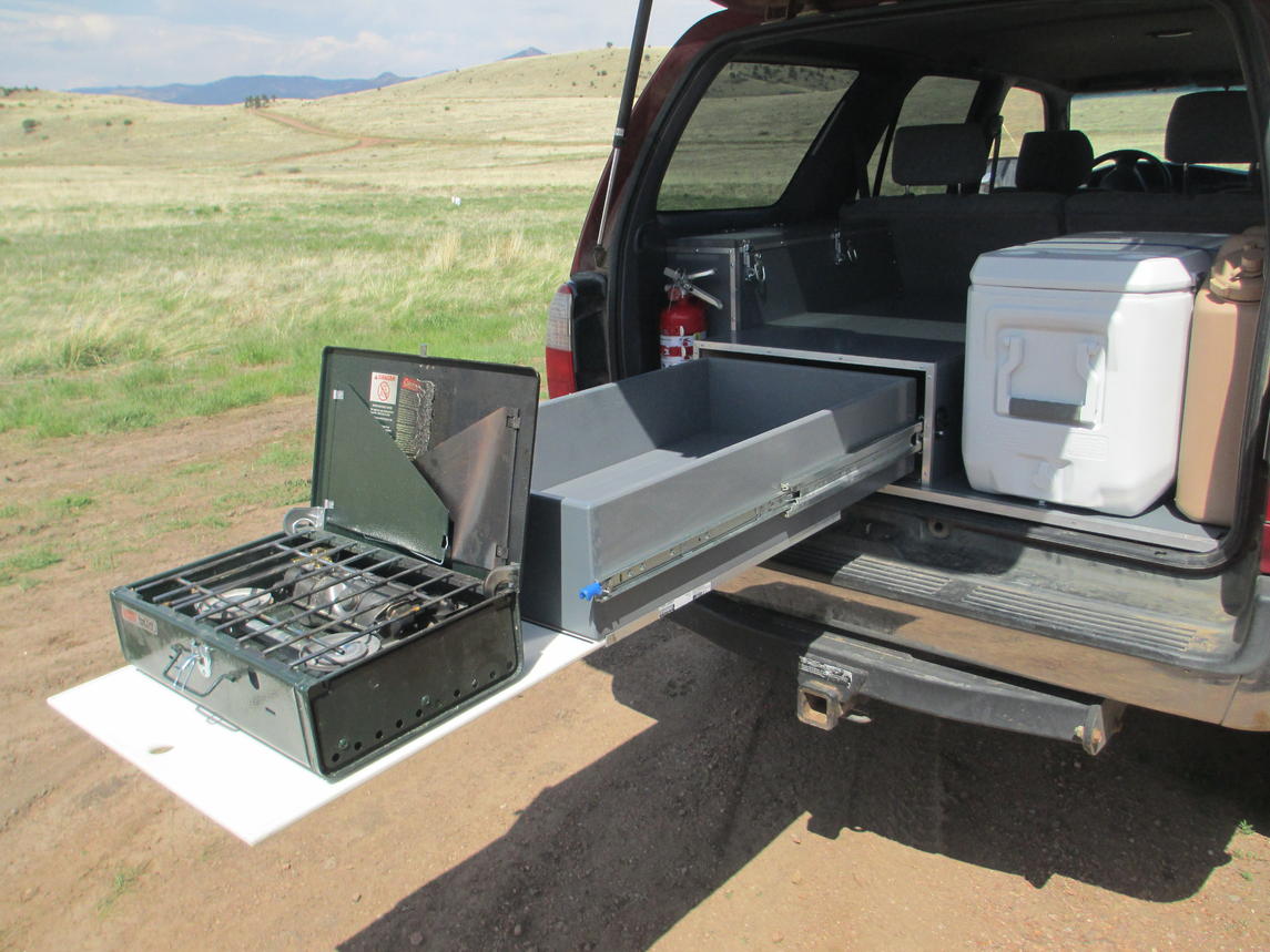

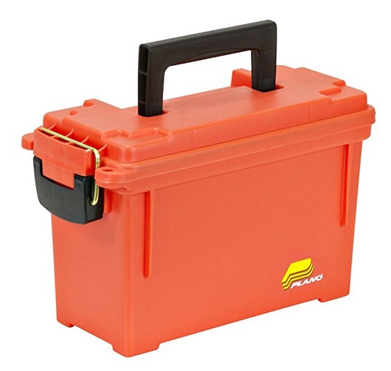

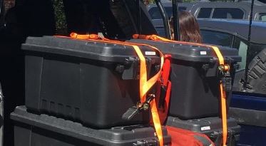

I carry a lot. Most of the stuff is packed into these two heavy duty tubs. They are not cheap but a 200 lb person can stand on one empty and it will hold your weight.
Two of these:
https://www.amazon.com/gp/product/B007TOJ9DY/
Two of these:
https://www.amazon.com/gp/product/B009YSFT7S/

PS, I do like those Plano totes that Brian shared. I might get a few for my garage & store extra 4Runner parts in there.
