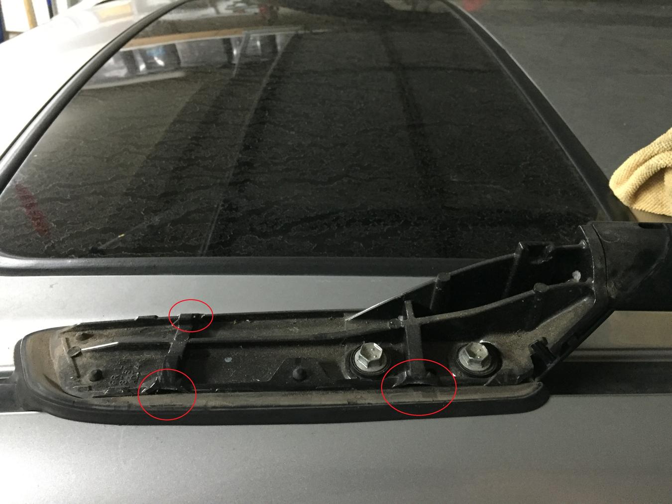

Would be a big help to everyone else if you posted a couple of pics of the underside of the cover that shows how the clips works, ie. type of hook, direction and what the slots on the roof look like....

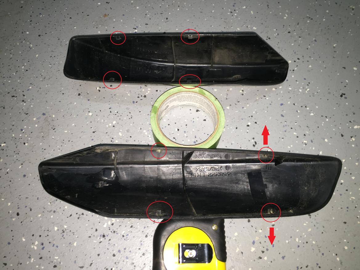

Re the plastic covers on each of the 4 corners, I figured out how to get them off without damaging them. The trick is knowing how the 4 tiny clips on each cover hold them on there, so that you can release them without damaging the cover. To remove them, you need a slender right angle tool such as pictured below. The tip you use is the 90 degree tip in the bottom right of the pic.
As someone said, leave the truck in the sun for awhile or a heated garage, whatever, so that the plastic covers will flex easier without damage.
Slide the tip of the pick tool under one side of the plastic cover, say about 1/4 or 1/3 of the way in from one end. Now turn the pick tool 1/4 turn so that you know the end of the pick is pointed straight up. Pull out (horizontally) gently on the pick tool, which will stretch the plastic cover outward just a bit, releasing the clip at the base. Now do the same procedure, 1/4 to 1/3 of the way in from the opposite end of the plastic cover, releasing that clip. Now with one whole side of the plastic cover released, if you push up and in on the plastic cover, the back clips will now release themselves.
Et voila -- the cover comes off without damage. I sold my SR5 rack, so sorry, I can't provide any pics of the inside of the plastic covers, or the procedure. Now the two bolts at each corner of the rack are exposed and it is obvious how to unbolt the rack from the roof.

Know its an old thread, but in case anyone runs across it from a search like I did, I thought I'd add a few pictures. Hope it helps.
Cheers
