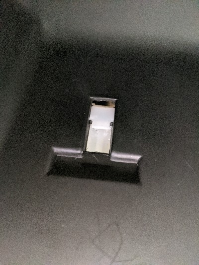

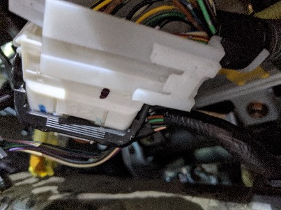

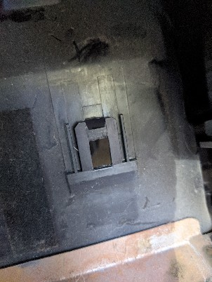

I'm in the same boat currently, wanting to completely remove my antenna wire. Almost there. The antenna wire is taped *really well* with green tape, to plastic tabs embedded in the steel dash reinforcement bar. I broke one tab off before I learned this. Cut the tape on the 2nd, but having trouble reaching the 3rd. Been removing the glove box components for access, but am stumped on how to, specifically, remove this one clip (pic). If anyone can describe in detail, I'd sure appreciate it. I don't want to break it by guessing which way to push or pull or slide etc.
That clip is on the #2 lower panel airbag assy thingy.
Answered my own question, new pics showing the clip...
