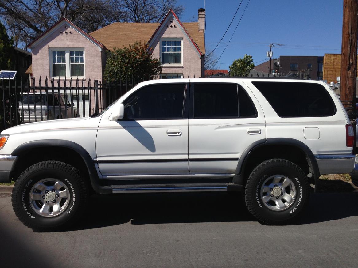

Hi I have a stock 2002 4Runner SR5 that I want to get lifted & put on bigger tires. I've attached a picture of one I saw that I really like. I want the exact same lift/tires as the one pictured. Can anyone give me a guess as to how much of a lift that is and what size tires that 4Runner has?

I can't tell you what kind of lift the picture has, however, depending on where you are in Dallas and when you want to have it done, I'd be happy to come help you. I've put lifts on two 4runners including mine
Looks to me like a 1" at the most, but looks stock and 265/75/16 BFG AT's. Probably a 99 with the highlander coils based on the picture.
Measure the distance from the center of the wheel hub up to the fender lip. Stock is about 20 inches in the front and 20.5 in the rear.
