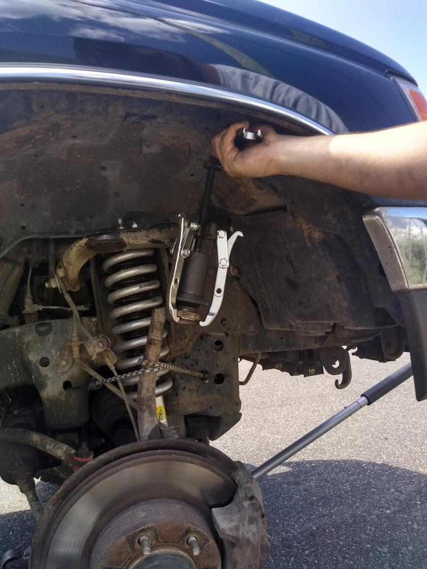

Here's the removal setup:
3-jaw puller with ~3" sleeve that was included with the Autozone "Master Ball Joint" kit..

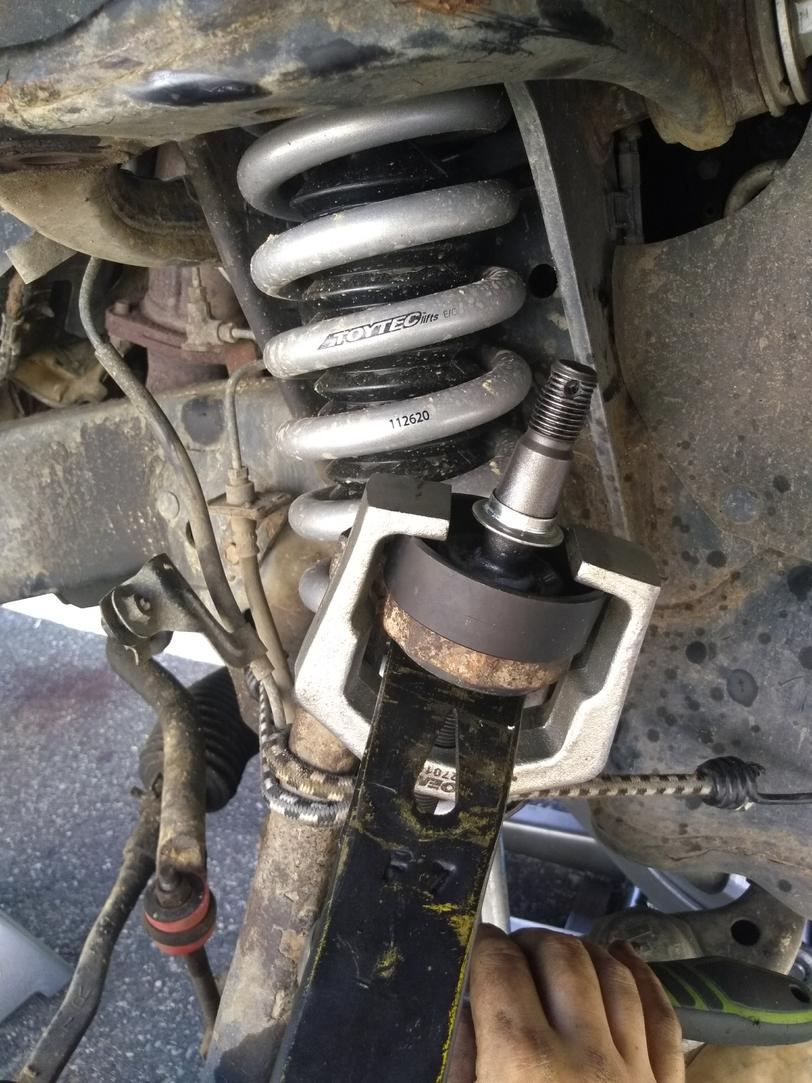

and here's the installation setup:
Here I used the large Pitman Puller, along with ~1" open sleeve that was also included with "Master Ball Joint" kit from Autozone. You will need to put a flat piece of metal between the puller and the new BJ, I used a pry bar.

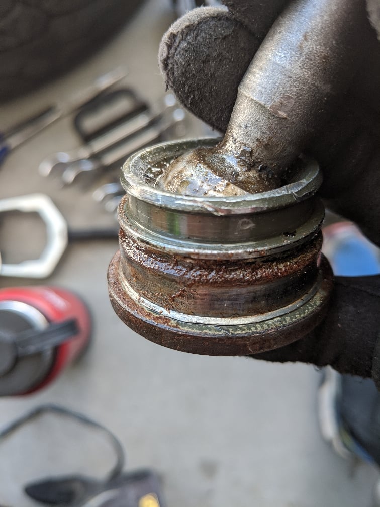

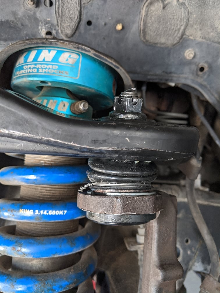

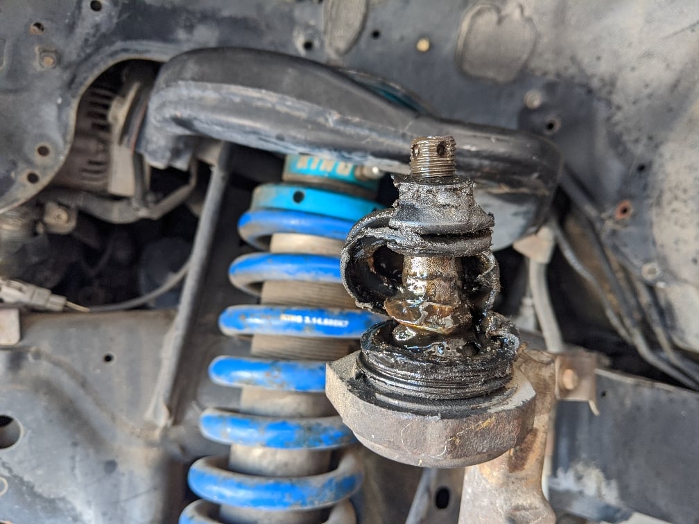

Gave this a shot today. AutoZone didn't have the exact set so I had a mismash of O'Reilly's and AutoZone sets. Once I found the right combo of adapters it worked beautifully... Even got this nasty rust-seized piece out, after about a gallon of PB Blaster.

That's some great information. Wish I had this before replacing mine. spent about 20-30 min torching those out :flamethrwoer2:
Sent from my Pixel 2 using Tapatalk
Impressive......that looks likes it would never have come out!

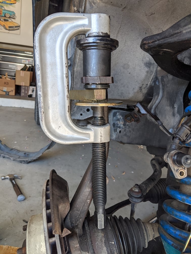

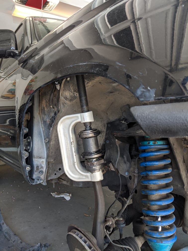

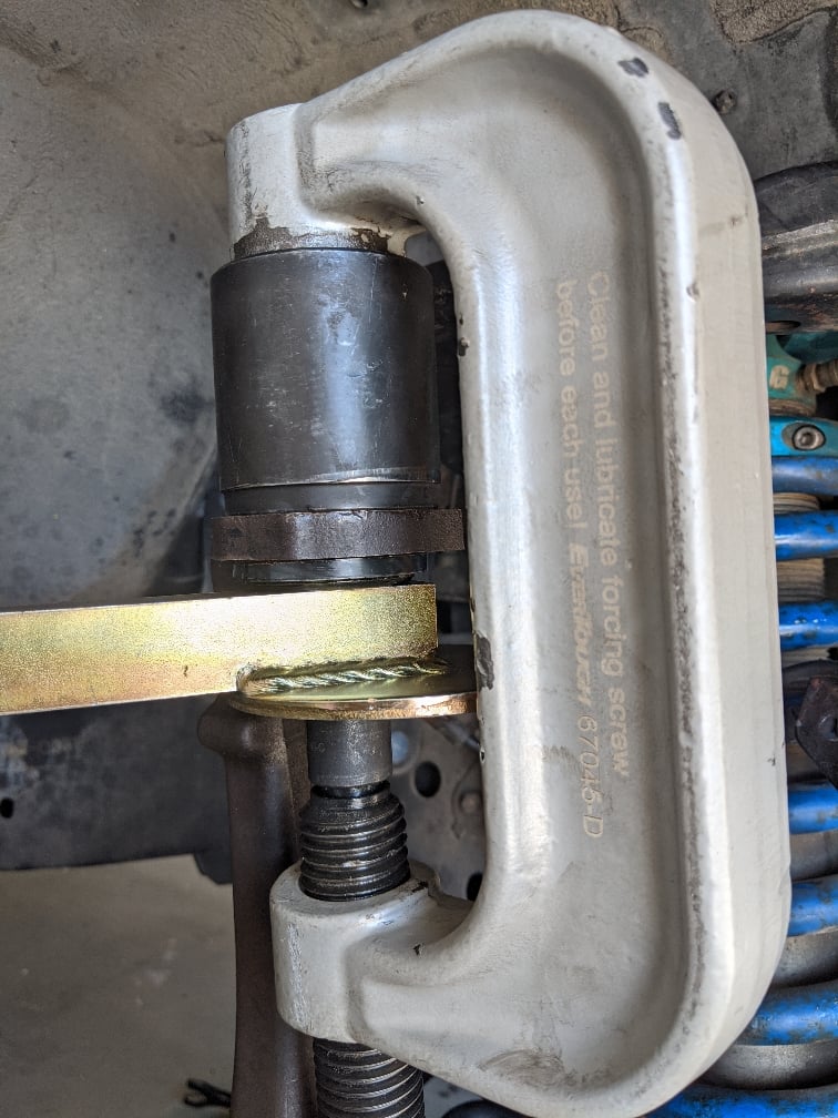

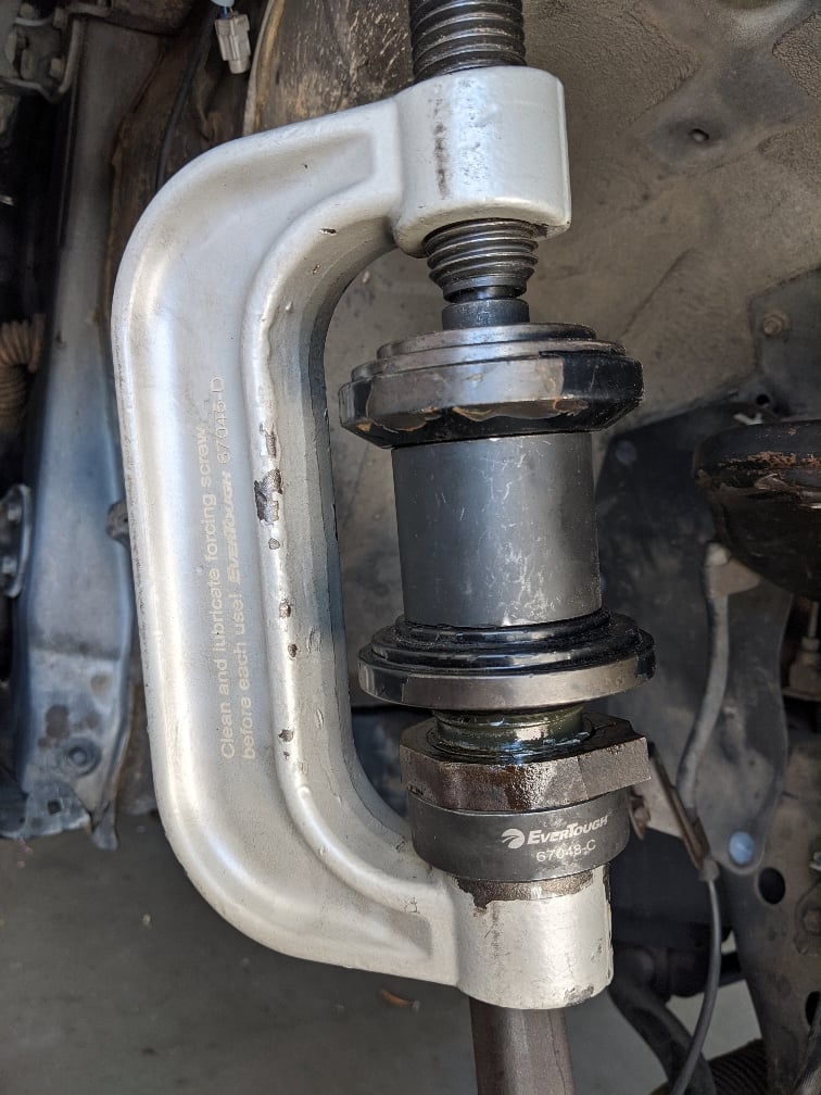

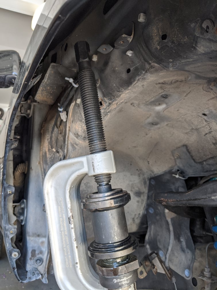

To be fair, I needed reinforcement on the passengers side. I'll include the setup I had to use for future reference for anyone who comes across this thread. The large press CAN fit in the wheel well, but you'll have to remove the fender liner and accept tight working conditions and little room to work the wrench. Apply extra patience and it can work.

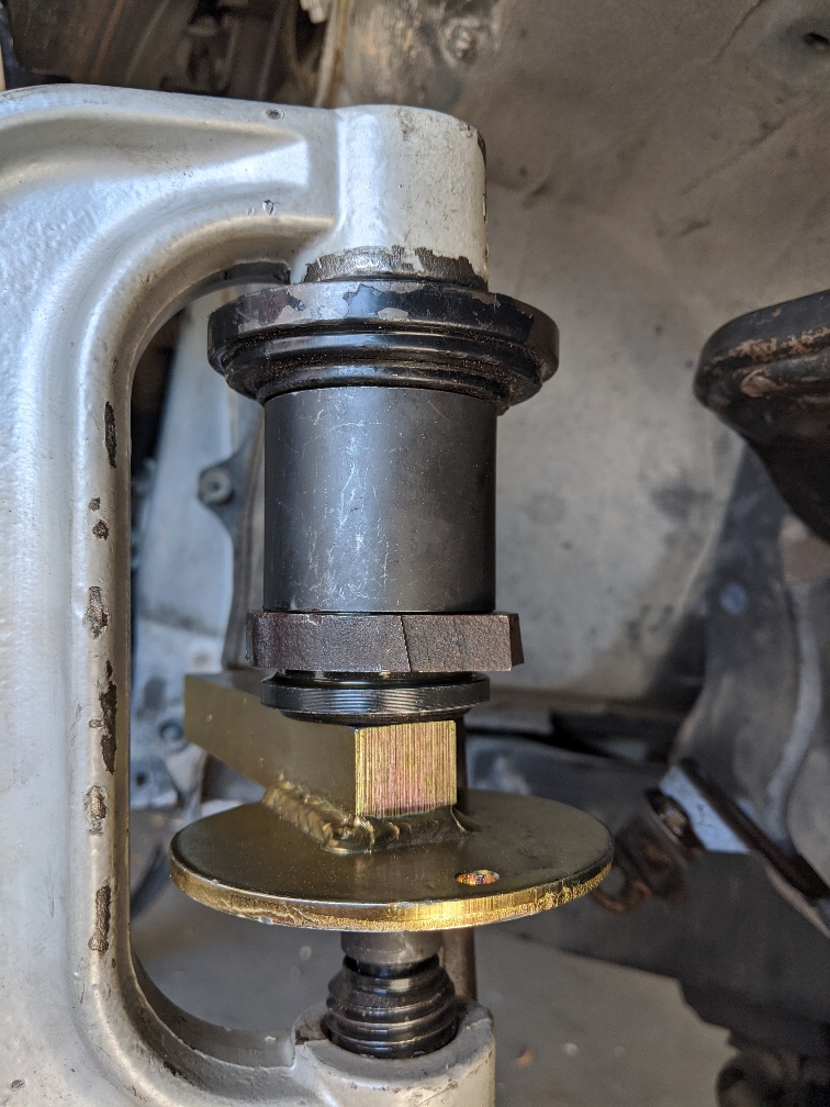

Installation set up. Precious little room at the bottom of the press to attach the wrench to. Working room only allowed about an inch to two inches of movement each rotation. Took a while but I needed the extra a** the bigger press provided. I had to remove caliper to make this work.
The gold piece of metal was something extra laying around in the garage. You just need a flat piece of metal to protect the bottom of the UBJ as noted by the OP.

I don't have a 3-jaw. I rented that too.
The 3-jaw worked fine on the driver's side but wasn't budging the passenger side, so I had to use the larger press. I just wanted to present another method in case someone reached the same point I did where the 3-jaw wasn't working.
