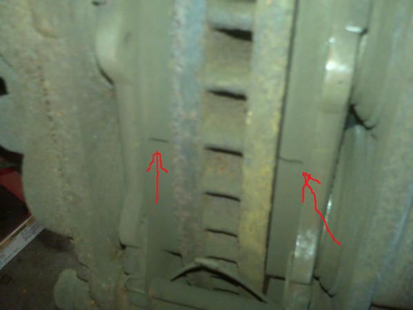

If you remove the tire and look at the rear of the rotor/caliper, you can see a horizontal groove in the middle of the pads(see pic) this is a visual indicator of life left. These have 30k on them and are at half life.
at about 1/8 thickness left, there is a little "nub" of metal that will be exposed and begin to squeal as it hits the rotor surface. This tells you its past time for new pads, as this will begin to destroy the rotors.
