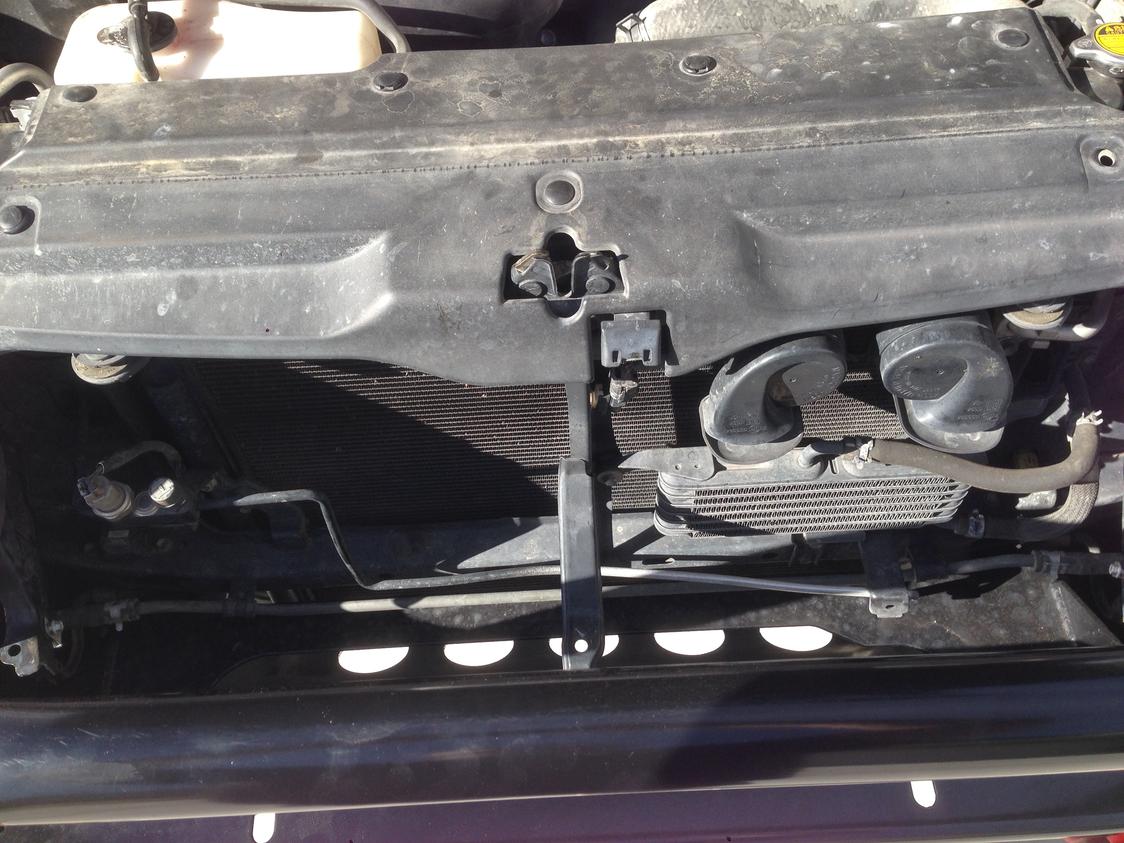

I have a tranny cooler on mine, it was factory, but the PO replaced with slightly bigger one as he towed a fairly big boat
Nice!! I have a 2004 Limited V8 with a tow package. Is that it in the lower right corner in this picture? Shows how much I know if it is.
