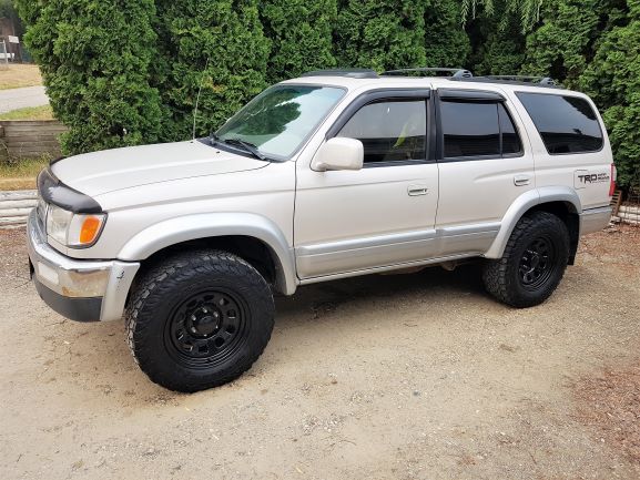

I'm at 492,000 KM now and my rear axle seal just went . Pretty decent mileage for seals . This truck's been awesome actually.
