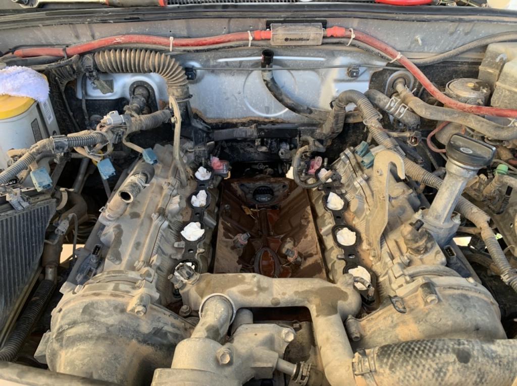

My starter failed at about 198k in my 04 V8. It kinda stumped me because I had sunk the vehicle in the river 3 days prior so I thought it was due to water damage. After some diagnosing I replaced it with a rebuilt OEM brought from the nearest dealership. Took me a Saturday morning with a friend. Wasn’t too bad looked worse then it really was.
