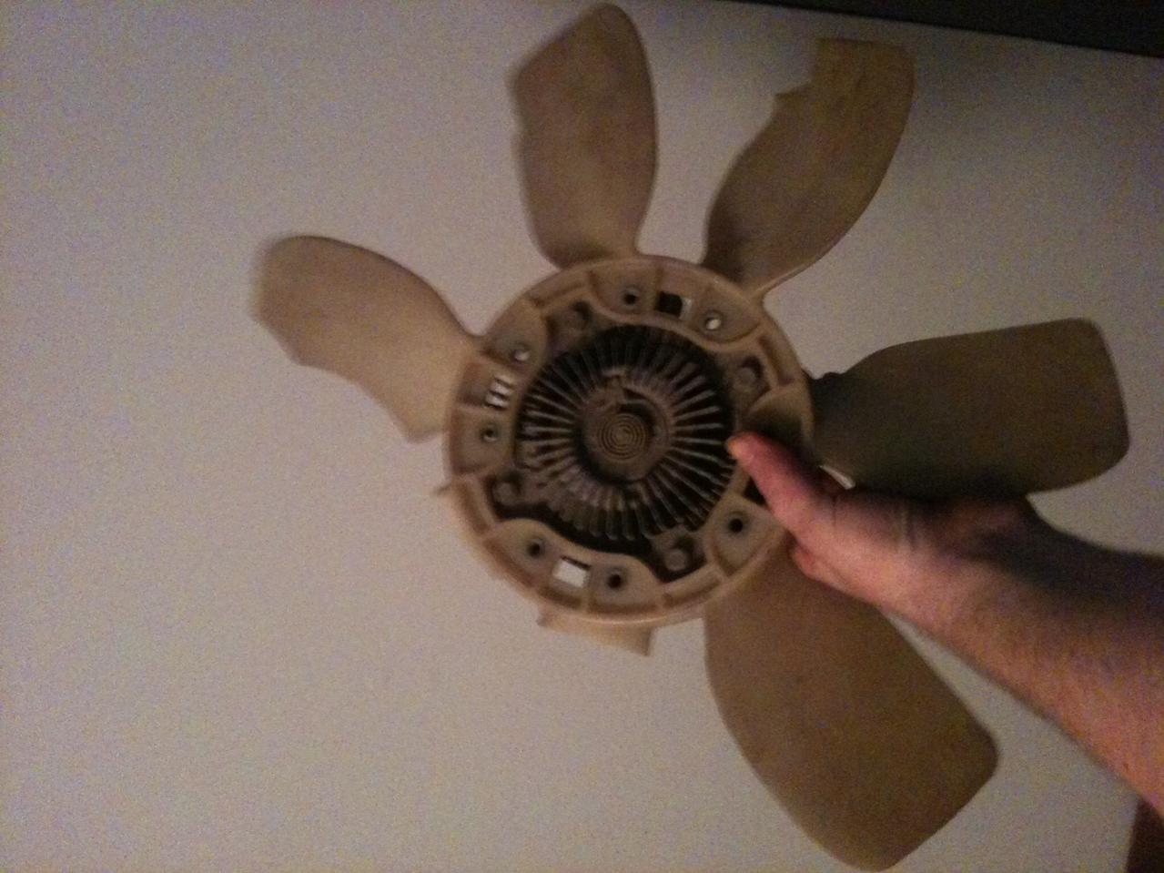

I know this cuz i have done it. Mud has knocked out my starter twice alternator 4 times, fan well scroll down and you will see. My last axle ended up going with a hell of a lot of gear play (form when my dad had it) As for depth on the drivers side i went through a flooded intersection and the drivers side dipped down in the gutter and water came up a inch on my side window.
