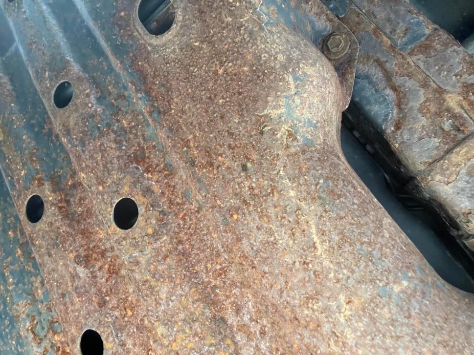

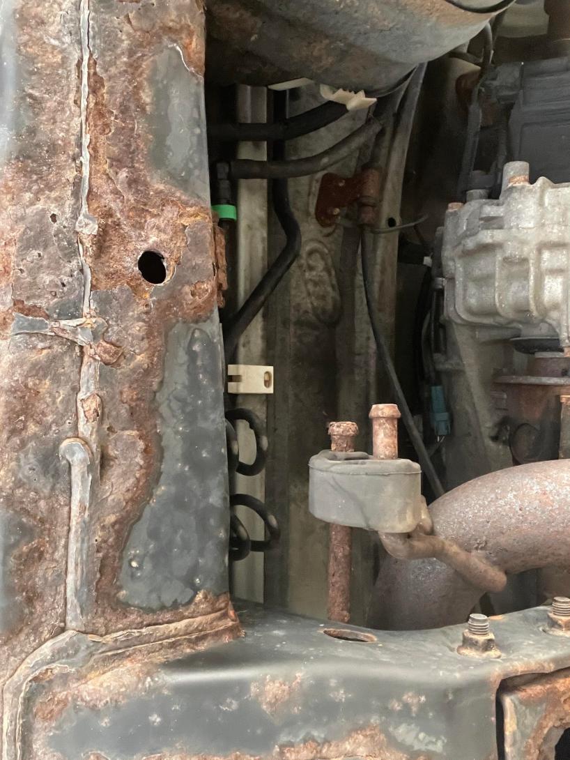

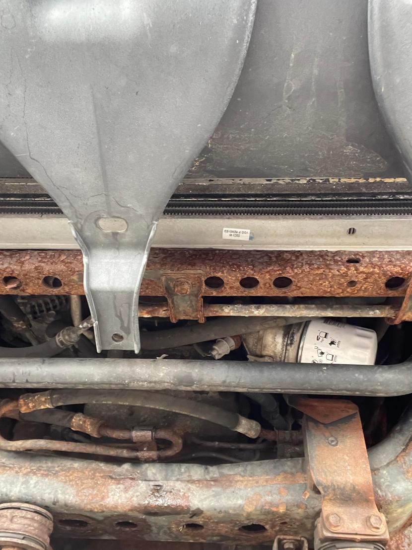

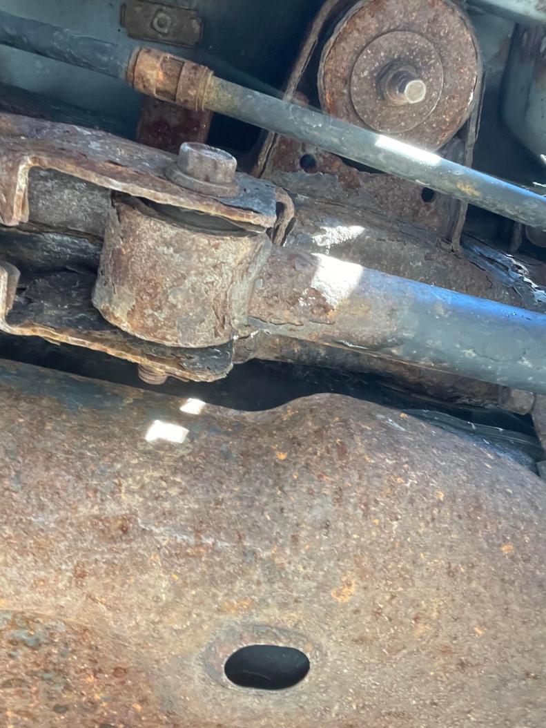

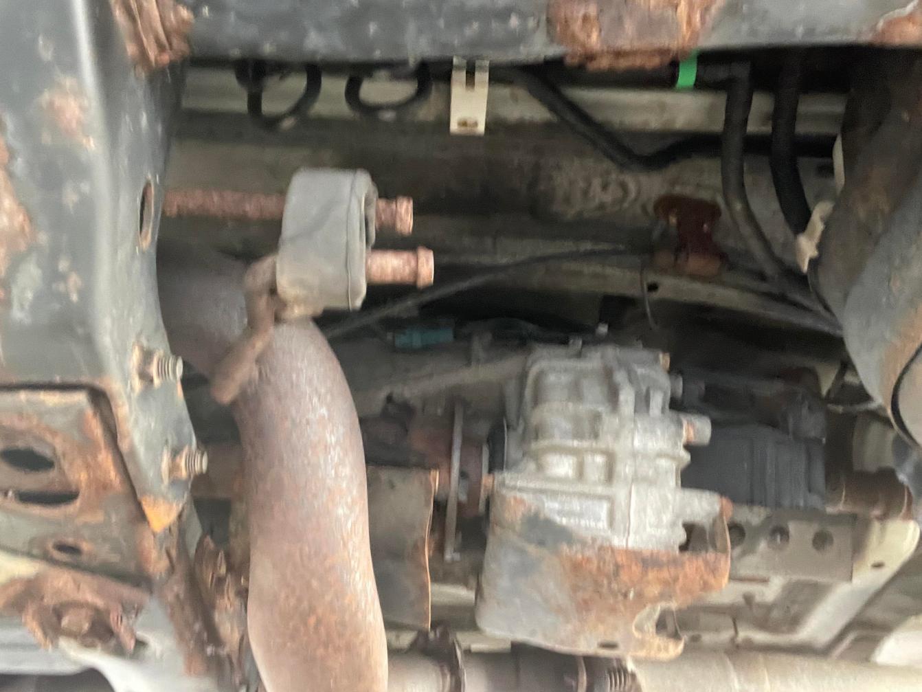

I'm in the market for a GX470. I see a good amount of them for sale with different degrees of frame rust here in the PA/NJ area.
Obviously I'm passing on ones that look like Swiss Cheese and ones that look like its just minimal surface rust are high on my list. What about the in between vehicles? Could these be cleaned up and protected with something like POR-15?
Here's a few pics of a frame of a 2005 GX that's available. Pass or worth a look in person?

That's not too much IMO, but it needs attention to slow down the process.
Wire brush, sand, prime and paint,. Then use some Fluid Film or similar on the inside. The outside is usually not too bad, as in your case, but it's the inside that will be worse and if left untreated will continue until it holes through and weakens frame.
As was mentioned, if you can get one not rusted, that is best, the one you're looking at will require yearly attention.
