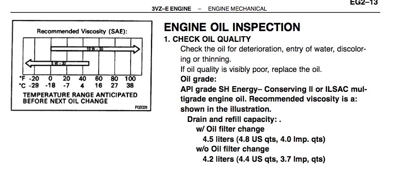

G Genesis98 New member Jan 21, 2008 #1 I have a '90 3 litre 4runner, how much oil does the manual say for an oil change? (I have no manual)
G Genesis98 New member Jan 23, 2008 #2 I know somebody has to know the answer to this question, help a guy out!
9 90whiteRunner New member Jan 25, 2008 #3 This should do the trick. straight from the service manual... Attachments oil.jpg 96.7 KB · Views: 293
