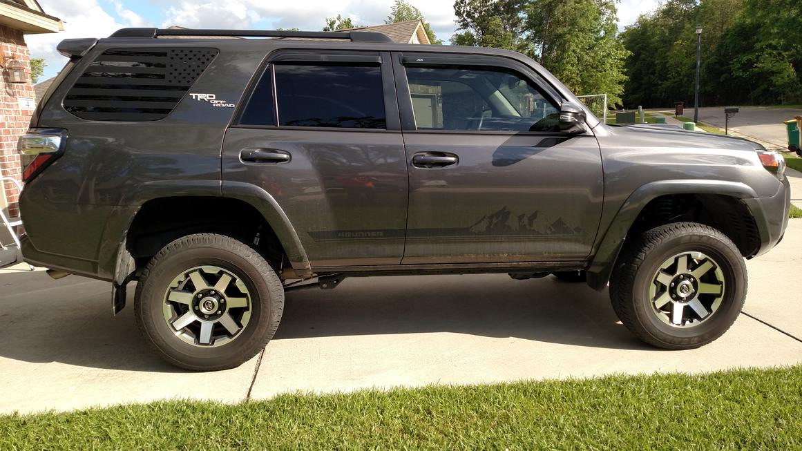

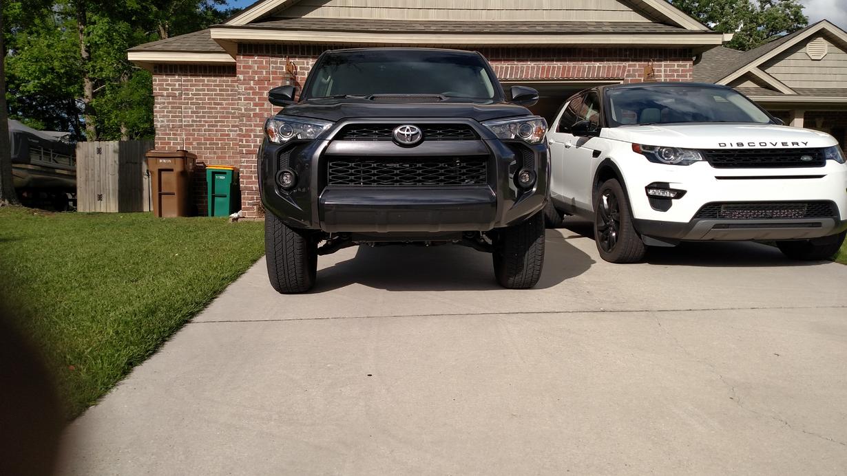

I installed Bilstein 5100's all around (front set on zero), with Dobinson's 75mm(3") lift coils up front and Dobinson's 50mm (2 1/4") rear coils yesterday. Post lift measurements were a bit shocking. I gained 5" up front and as expected, about 2.25" in the rear! I am 1000% positive, the spring perches up front are set correctly at the bottom notch. I don't have a winch and bumper installed yet so I know that's going to bring things down a bit but the truck sits pretty damn level and it makes zero noises. I believe the alignment may bring it down slightly but not 1.5". The below measurements were done before I drove the truck around too, so I plan to double check them today after work.
Pre-lift/post-lift measurements(Hub to fender):
Front Driver: 19 5/8"/24 3/4" Difference: 5 1/8"
Front Pass: 19 3/4"/25" Difference: 5 1/4"
Rear Driver: 21 3/4"/24 3/8" Difference: 2 5/8"
Rear Pass: 22"/24 1/4" Difference: 2 1/4"
Truck tracks well and definitely rides stiffer than stock. Zero lights on the dash, although I did perform the ZPC before I even started the truck after the lift.
My driveway is on a slight angle so the picture may be a bit deceiving with regards to how level it sits.
Anyone else see this much difference in their experience with this combo?

I don't have that combo but I did notice a good amount of settling after driving my 4runner around after the front/rear leveling lift. The front especially was very high and the camber was off. Gave it some speed on a few speed bumps and hit the brakes pretty hard a few times. It settled real well.
Thanks for the replies guys! So after about 100 miles, I took measurements again and the front settled in right at 3 1/4" of lift. The back did not drop a bit. The spring perches were clearly on properly as the springs clocked appropriately and I have zero noise. I had the truck aligned today and it drives better than from the dealership. Now, to get the tires mounted tonight or tomorrow!
