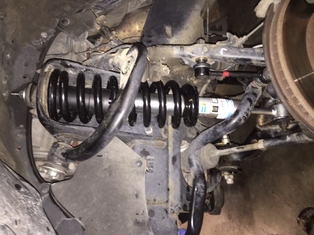

I did a fair amount of research and went with the Bilstein 5100's up front paired with new Moog V8 factory replacement coil springs that I purchased from rockauto.com for $44 (I have a V8 Limited AWD)
Went with the 255/75 17 tires and got rid of the stock 265's, the ride is great and the 5100's allow you ride height options up front as I'm sure you already know. Setting wise with the Bilstein's, I went one notch up from factory which gave me right at 2" up front from my stock setup measuring from the ground to the bottom of the fender. Part of that is the taller tires obviously.

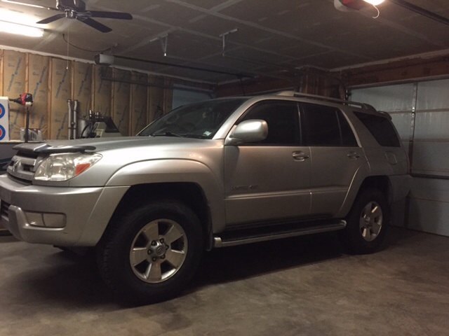

AWESOME! That's what I'm after.
Please post some pics when you get a chance!
Sorry not a great pic, weather has been crummy here for a while. I will send you an update after I get an opportunity to clean her up!
