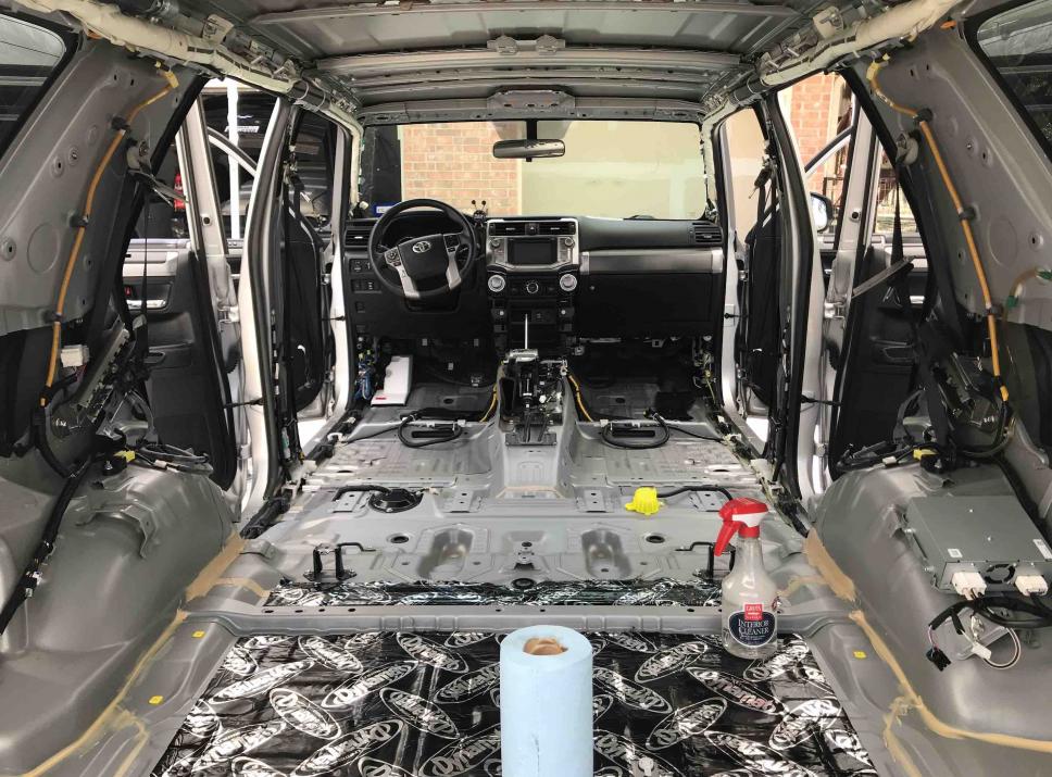

I probably added about 50 lbs max. I used some left over Rammat and and their foam for the back doors and rear hatch. Used Dynamat and Norico Red closed cell foam for the floor and front doors. The roof only had Dynamat. Doors helped a lot, floor much more in my opinion.
I added a Borla exhaust and on road trips going uphill in a lower gear, the sound was too much. Now it's much more tolerable.
Materials were about $400, though I had a bit of Dynamat left over that I gave to my nephew. That was the biggest cost. I don't include my time or my helpers time in the cost.
As for the ROI, it's a subjective thing. It won't make it as quiet as a Jaguar, but it makes it more tolerable on long trips. It was a must for me, so definitely worth it.

I used about 90sq ft to cover the entire cab, doors, hatch, floor, roof, and hatch. I estimate about 100lbs, but spread out over the entire cab

Wow, looks like a pretty big project. Thanks for posting the pic.
