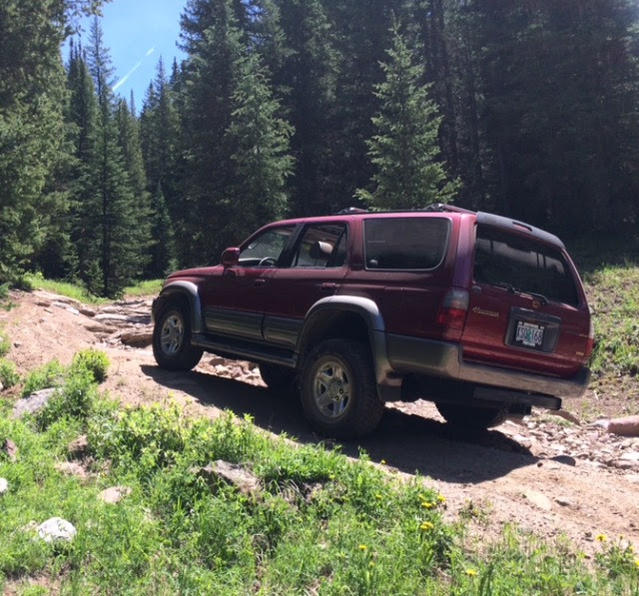

Evaluate your needs. I will say this, though: if you find yourself with a T4R and get involved in the community, you'll probably find yourself in some places you've never been, and wish you had one.
In the following pic, this was the point at which I had backed down a short ways in order to engage my locker. Dry, loose surfaces can be a killer, especially with my mild Cooper tires. With the locker, I went tot he top. I would have had to turn around without it. This was out of Shrine Pass in Colorado.
