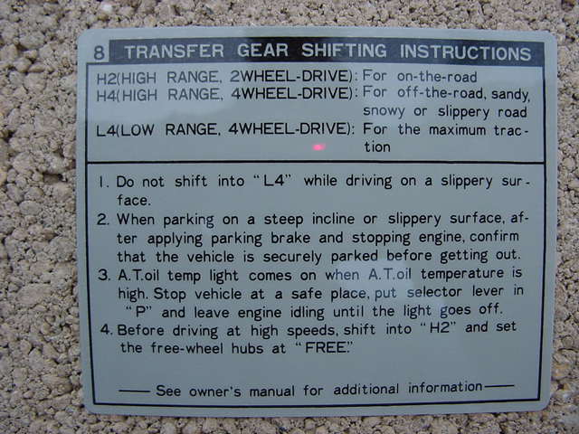

Full-time 4wd (in your 4runner for example) allows for slippage when you turn a corner on dry land. Your Torsen center diff allows for slippage...thus, no damage to your 4wd system.
This is what should be on your visor.
Crap... here's the bad news. About 2 weeks after purchase, my Uncle said it was a good idea to drive it in 4wd once a month, so when leaving the store, I put it in 4wd Hi and drove home. I made 7 turns and drove about 1.5 miles, not exceeding 35mph, all on asphalt.
Think I should have Toyota look at it?
Nah you'll be fine. Unless something breaks (and you'll know it) don't worry about it. Just caused some extra tire ware and the like.
