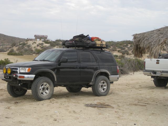

I put 10 lbs of shizzle in a 5 lb bag on mine for Baja trips, not a problem yet bouncing down rough roads. Probably over 200 lbs in this pic.
factory rails, Yakima attached to a confer

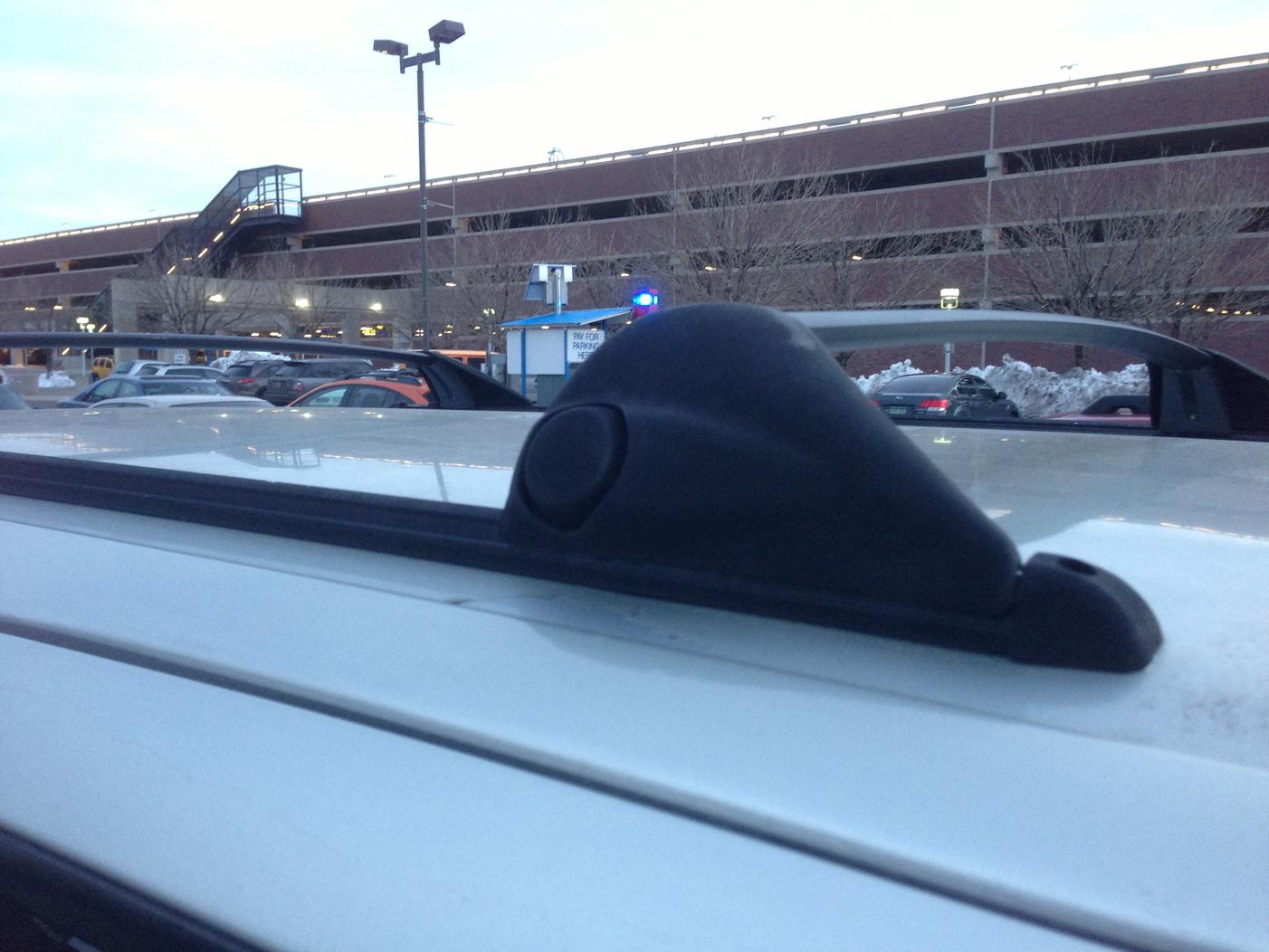

So I was reading through the link that Bryan1 posted and I noticed that my stock rack looked a lot different than everyone else's.
Long story short, I was having a little too much fun in Mexico a few years back and I ended up rolling the 4runner. The roof was smashed in a bit so I'm sure they had to replace the roof rack. I'm thinking they were probably try to keep cost down and put this guy on. All of the ones I'm seeing on other 4runners seem to have a vertical knob that holds them down. This one comes in from the side, and to be honest it feels a little shaky. Has anyone seen this type of rack on a 4runner before?

FWIW, none of that resembles anything I've personally ever seen on a 3rd gen 4Runner...
