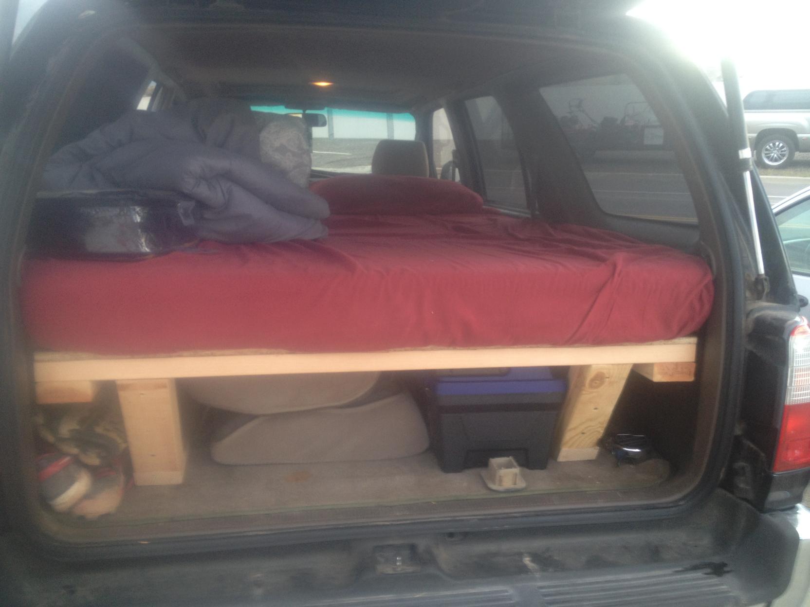

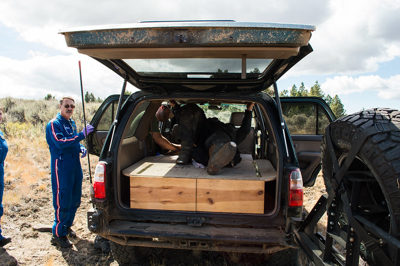

Here's mine with a pretty big dude (with a pretty broken leg too) laying on it... Now sure how tall it is anymore... I'll go grab a quick measurement and a picture.
I honestly think this is as tall as you'd want to go... I don't sleep on it anymore, but when I did, at 6', I could still move around a bit in there... Enough to roll over, crawl around, etc. I think any shorter and it'd be pretty tough to get in/out. Or fornicate.
I didn't take a picture but the front half folds up so that you can store stuff under there too... I usually keep my camp chairs, stove, and propane tanks under there. Other stuff I don't want flying around.

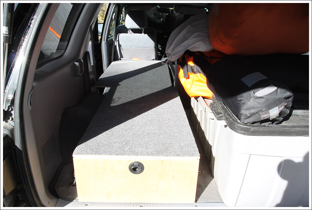

DSC_0200 by Alex Wilson, on Flickr

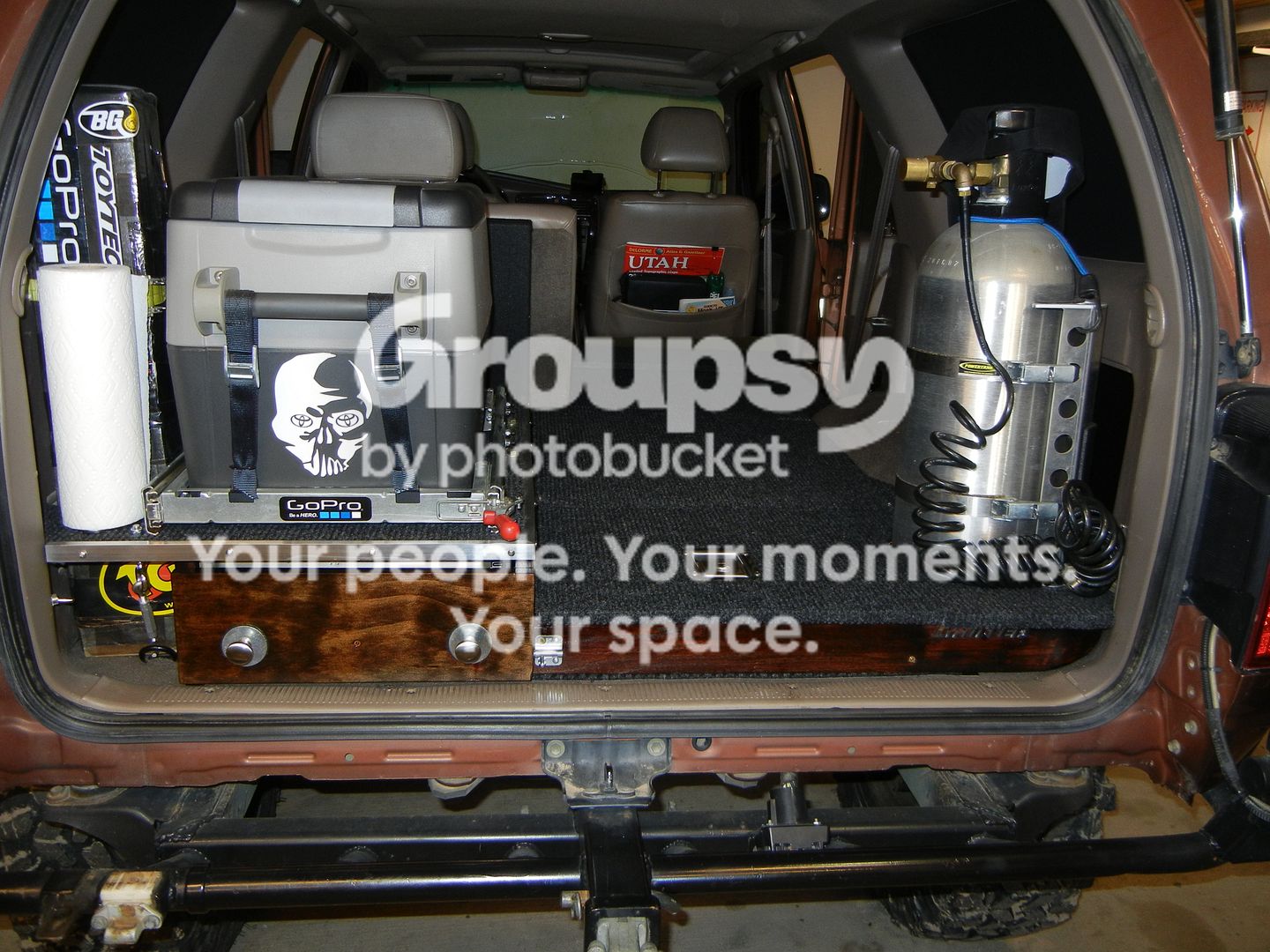

I ended up having mine be way too tall, dont get me wrong it works but more room would be nice. I would say keep it as close to the wheel wells as you can, buy a roof basket or a cargo box if you need more cargo space. The one good thing is my platform can fold up and i can keep my rear seats.

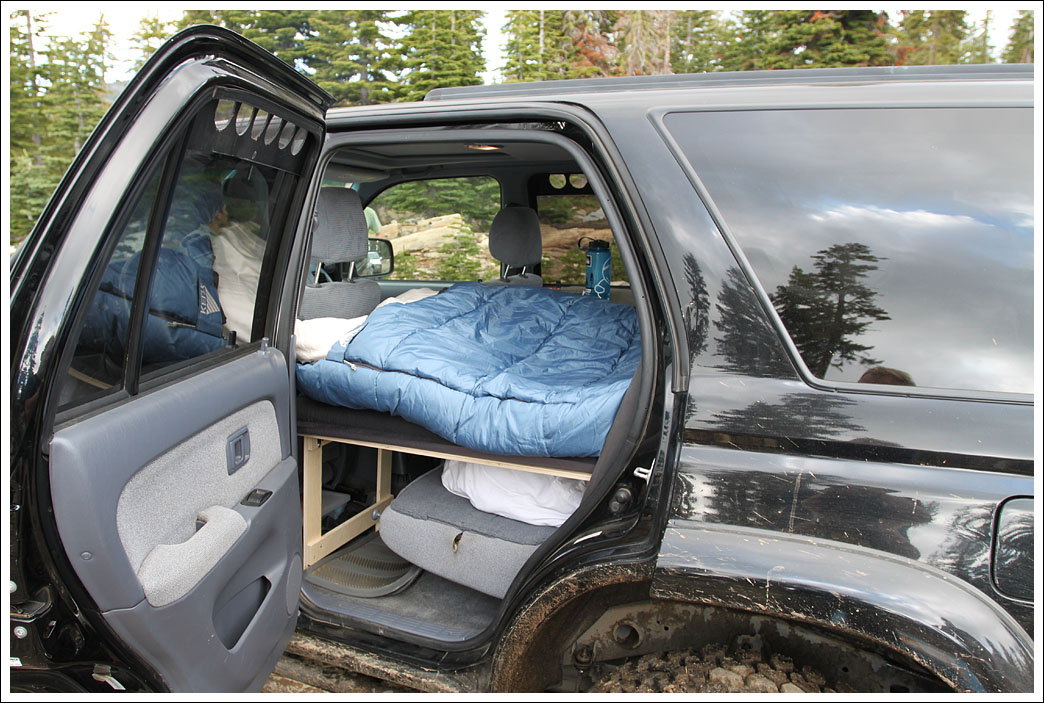

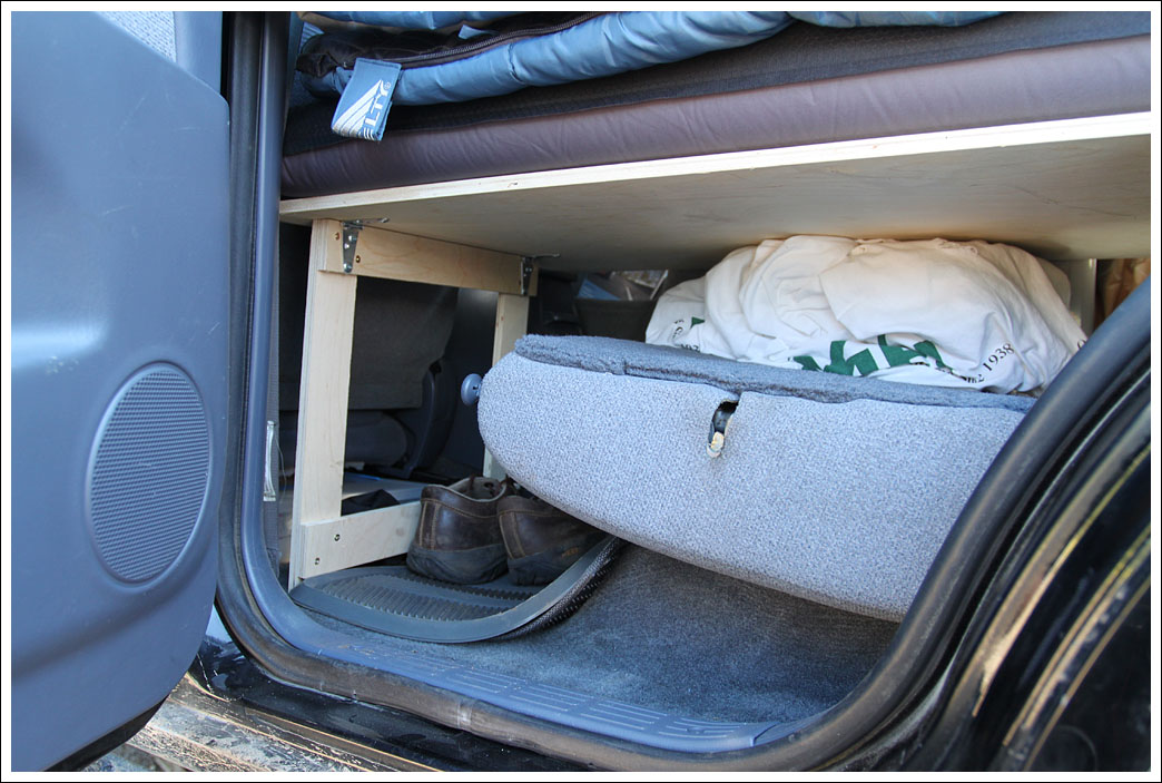

My set up was similar to both above with a 6" mattress. My wife and I both slept on it for two weeks... worked great. You couldn't sit up, but you could be on all 4's to crawl around. I'm 5'9 170, she's about 5'5" 110. Wish I could show you pics, it was pretty inexpensive and quick to make... the storage bins worked great, and we fit recovery gear, camping equipment, tools, etc. Two coolers fit behind the front seats. our luggage we put on the bed while driving, and on the front seats while sleeping... only thing on the roof, was a hi lift, folding chairs, and 5 gallon gas can. Forgot my wife posted pics in her blog about the whole trip....https://ultimatemancation.wordpress.com/2012/08/page/3/ look at post for aug 7th 2012... a place for everything... the right sized storage bins are key!!

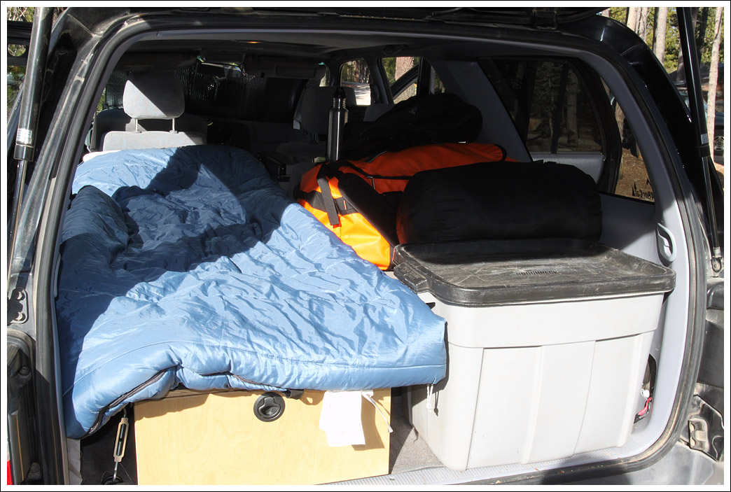

i made one for my 2nd gen clearing the wheel wells but also level with the folded down back seats. the platform was two pieces (not hinged) so you could slide the front half backwards and use the seats without removing the back half. the under support was T shaped with 2x6 and left a lip for the front piece to rest on, the front on the rear seats.
worked really well for 8 months in south america to san diego.

still working on mine, and its way more simple than most, but i think its 9" of space under to store stuff, and sits about 10" high. im leaving the sides open as ill be the only one sleeping in it
stored away with full use of rear seats
slide pulled out to sleep on
im 6'3 and around 280, and i can fit comfortably on it, although i cant stretch out fully
