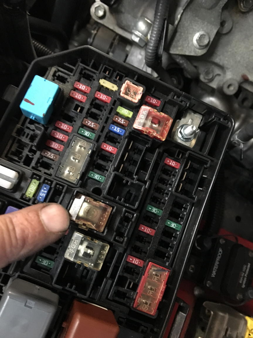

More to come later- but- I blew this 140a fusible link in the underhood fusebox.
The other links pull out. This one- I can't get the sucker out. Are there tabs or something? I dont want to f it up more...Thx
**EDIT** My solution on post #42. This fuse is bolted in from behind!

Do I see a tab to release it?
I hope it didn't weld itself in! :bash:
The tabs you see are for the lid.
I'm confident it didn't weld- the fuse burnt clean. I'm at dealer now and they are telling me it's screwed in from the back. Yay!!!

I have a feeling an Antman tutorial is in the works for how to take the damn fusebox apart- assuming my truck doesn't melt first.
You DO NOT want to know how I'm driving around with a blown 140(!) amp fuse under the hood. Nope- don't wanna know that...yet. LOL
Any of you guys know for sure how that thing comes out? I'm gonna start tearing into things in a bit.:thanks:
Fuse box is IMPOSSIBLE- like a puzzle.
I dunno- I'm gonna get a new fuse and go from there. I seriously can't figure out how to get the box apart without breaking stuff...
Yeah- thank you! I actually just found that post and I'm gonna do it.

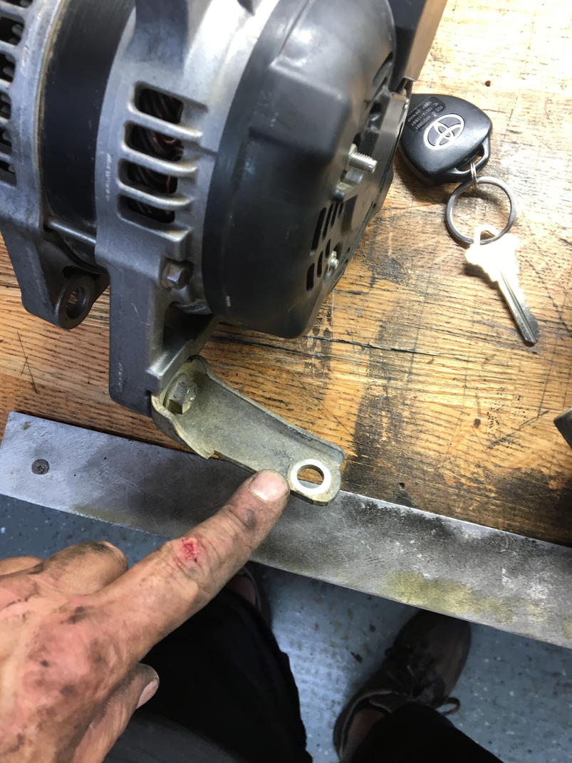

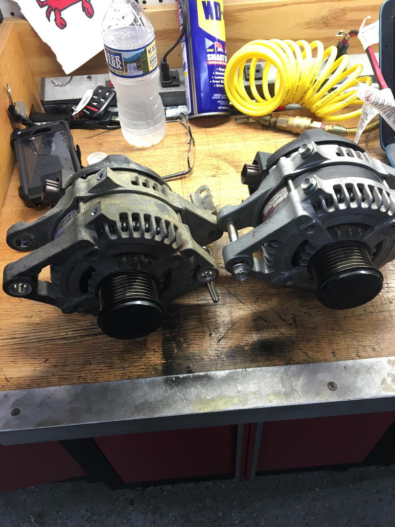

Today I removed my 100a alternator and replaced it with [MENTION=89562]bimrunner[/MENTION] 's 130a which he shipped me after the alternator group buy. Great guy- thank you!
Anyway, while wrestling with the alternator, my elbow pushed the battery cable into contact with the studded + terminal of the battery (I have a marine dual terminal battery). Just so happened the power wire to the alternator was grounded. The sparks were very pretty!
Anyway- I messed with the fuse box for 5 hours, took out all kinds of crap, took apart all kinds of crap and you know what? F it. What a joke. No reason for Toyota to do this other than to require dealer service to replace. Thanks.
I'll bypass that POS fuse and run a 4 ga wire from the battery to the Fusebox 10mm terminal and use a 140a circuit breaker.

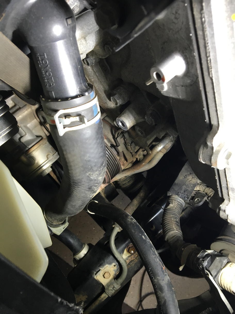

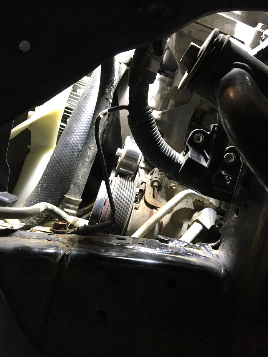

The alternator install went smoothly otherwise- just a little difficult to get that rear bracket bolt out - you can see it in the pics. I used a short socket, universal joint, some extensions and an impact and I won (minus a busted to hell hand).
Overall, it was worth it for 1/3 more power! I just gotta be more careful- think I'm gettin' old, lol.
