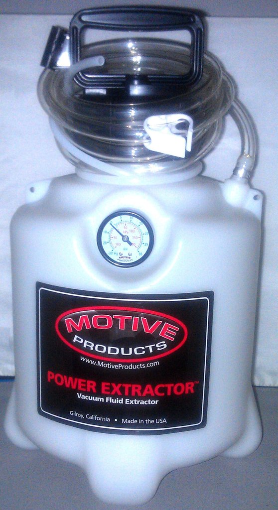

I'm done w/ those Motiv bleeder bottles. They make more of a mess than theyre worth.
I use a Motive Power Bleeder. Though I have not used one on the 4Runner yet.
It has made the job super easy on all the other cars. If I recall correctly it's under $100. I use it just for the pressure and do not put fluid into it in order to simplify cleanup.
Just refill the master after every corner. The key is making sure you have the right cap attachment for the master cylinder you are working on.
I have one, but it's a mess to disconnect. I liked the idea of using it just for the pressure, but would still have to remove it a few times to check the fluid level. I'm tempted to try one of these at the bleeder screws and maybe to remove some of the old dirty fluid near the bottom of the master cylinder instead of pushing it through.
