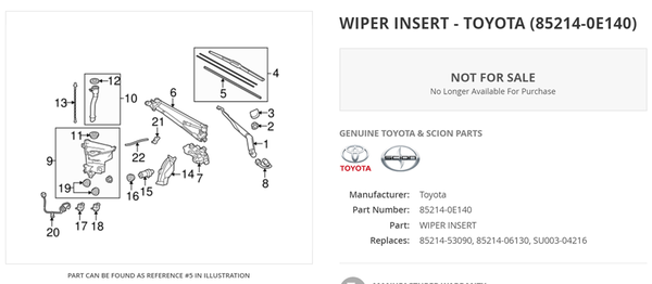

So those just rubber refill part numbers will not fit the 2015 and up ?
Is it different , does anybody have the 15 part numbers

I realize this is bringing the thread back from its resting place, but figured it's probably one of the more appropriate places to post the question...
Has anyone else noticed the wiper blade insert refills aren't exactly easy to find anymore? I'm not seeing them as available from the usual suspects online anymore. Is it just because of the rainy season, or has Toyota decided to phase out the insert availability in favor of replacing the whole blade assembly?
