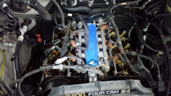

Thanks for the info, do you have a pic of where the v/c & head gaskets are located?
I circled the head gasket on your picture:
3e47726d-da2f-4999-808c-6531043eb356_zpshcgf8kjm.jpg~original
The oil looks to be leaking above this gasket. Here is a pic of the valve covers off:
20150722_104023_zps1kz7ycv3.jpg~original
Hope this helps!

Wow this thread got off topic real quick, thanks for bringing it back and helping me with my actual questions. Those pics are a big help, thank you for that. And yes, the leak looks to be coming from above the head gasket.

These valve cover gaskets leaking a bit is common. Often just GENTLY snugging down the valve cover bolts. will stop the leakage.
The torque spec is 53 inch lbs, take note that IS NOT ft lbs.
53 in lbs is 4.416 ft lbs.
Lots of people get carried away tightening the VC bolts, and either strip threads, or crack the Valve Cover.

Found the bolts and gently tightened the ones I was able to access without having to take things apart. Was shocked to see how loose they've gotten and am hoping that is the underlying issue. I am a bit nervous as I only have 400 miles on the new oil I recently changed and am just under the min oil level already. My car has not leaked at this rate before, so I am thinking I may have a cracked gasket or other problem since the leakage rate has increased so much so quickly.
Is it necessary to drain the oil prior to doing this repair? Also, is it possible to tighten all of the v/c bolts without having to take apart all the stuff above it?
You don't have to drain the oil. You can tighten the bolts but may have to get creative with those for the driver's side valve cover without removing the manifold. If you aren't comfortable doing it, take it to a mechanic.

Thanks for all the help, I really appreciate it. Going to tighten as best I can, clean up around the v/c's, fill her up with some fresh oil and see if the leak slows/stops.

If you didn't torque them all down evenly you could have tweaked a section of the valve cover open more than it was and increased the speed of the leak.
