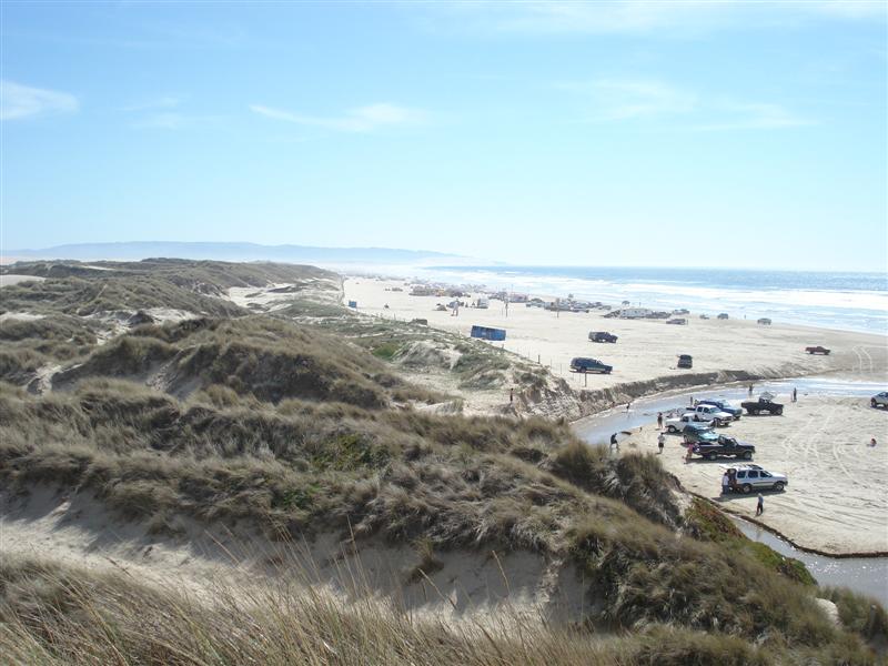

Hi, this is my first post on here. Looks like there are some knowledgable people that might be able to point me in the right direction... I enjoy ATVing and last weekend went to Pismo Beach (Oceano Dunes) to camp on the beach. I drove my 05 T4R SR5 (2wd) in the dunes towing my Outlander 800 Max. The Toyota did pretty good I guess, I didn't get stuck, but was scared with only a 2wd. I aired down to 10psi which helped... My question is has anyone really driven there 2wd T4R in deep sand before? All the big trucks were getting stuckat the access and I decided to hit the deeper sand pretty fast. By the time I got to the access road the trac control or whatever robbed all my momentum by cutting the throttle. This could be pretty bad. I made it, but if I had another 10-20 feet I don't know. What is the best way to drive this 05 T4R 2wd in the deep sand?? Are they any good in the sand? I just had short jaunts in the deep stuff, but worry towing the trailer. Is the Extra weight bad in sand, or does the extra weight on the rear tires help like in snow? Sorry for all the questions, but I like Pismo and want to know if I should be Sh%^$# my Pants or not every time I get into the deep stuff. Oh yeah, what about the auto lsd, is that good in the sand or does in inhibit anything?

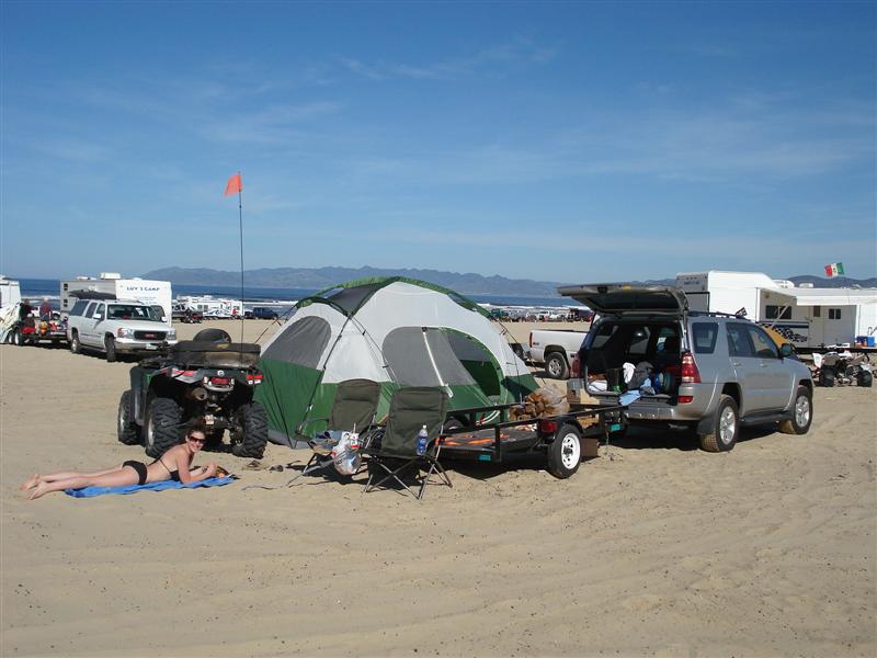

looks like a fun place you've got there!
But im not sure about what you should do as far as pulling plugs n stuff......
So are you not able to tip around in the sand like that?
btw- SICK setup! atv, tent, trailor, 4r & the Lady! :beer:

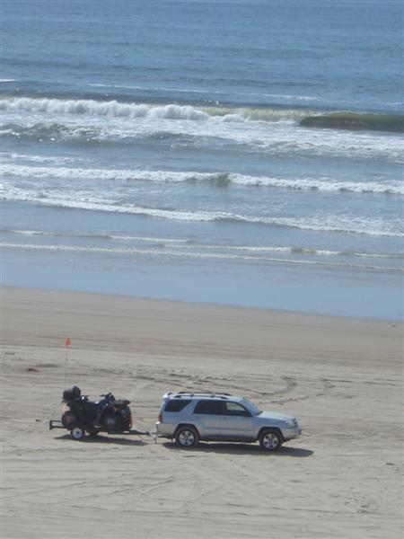

Not a T4R, but thought you might like it. Keep th advicce coming guys- Thanks!
