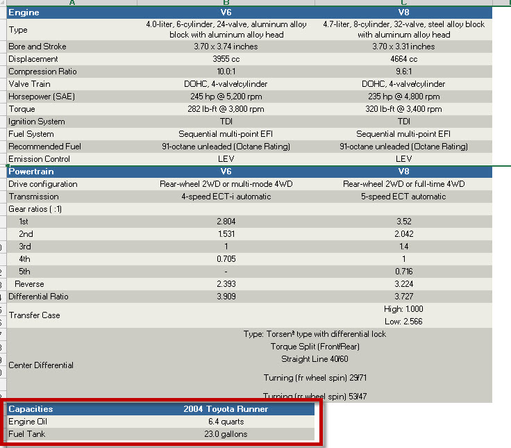

You're drawing out oil through the dipstick tube? Why not open the drain in the oil pan? Specs for my 2004 says 6.4 quarts.
Yours is a V8, for V6 it's 5.5 qts for drain and refill with filter change. I too wonder why he's not using oil pan drain.

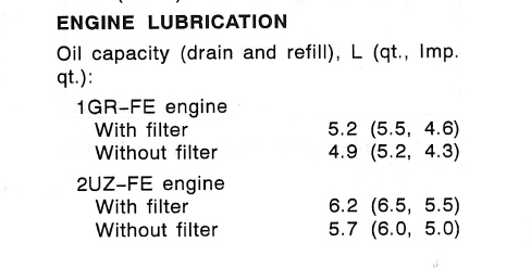

I was referencing a specification document I had. It shows 6.5 for oil, no mention of engine. It does for everything else but not that; really odd. Of course the owners manual says otherwise.
