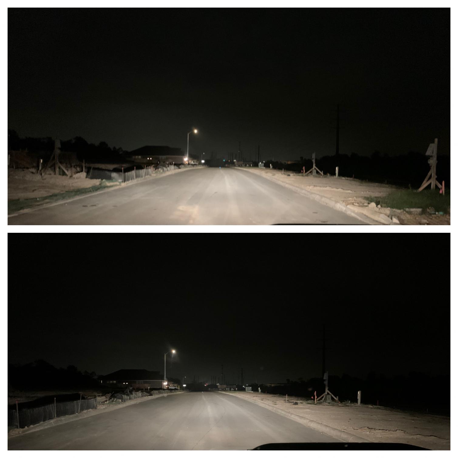

Hey all, I did the H9 a few months ago and it was a massive difference. I did the 9011s tonight and I have to say, it’s nowhere near as impressive. I’m certain the brighter pic is the factory bulbs. Did I do something wrong? Thanks in advance.

If I can recall, the H9 is double the output while the 9011 is about a 33% increase. Hard to really the differences in the photo but the throw seems better in some parts. I did the 9011 upgrade and found the increase in output to be great in the dark mountain roads around Yosemite and Sequoia.
Take another photo from the same vantage point.
Change one bulb back to the OEM 9005 and see if you can tell the difference side by side.
