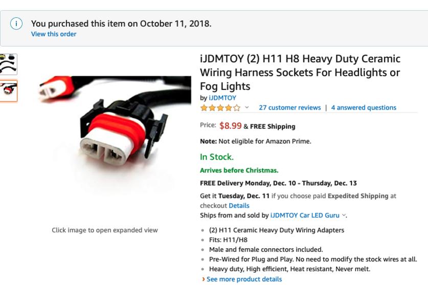

I had the low beam connector melt where it connects to the light bulb.
I ordered some high-temp ceramic "pig tails", and used those to replace the pig tail that melted. I'm running a plug-in light harness with relays from the retrofit source that bypasses the stock wiring and gives the headlights power via heavier gauge wires connected directly to the battery through relays.
(I should add, I never contacted the retrofit source about the issue. I don't really view the melting problem as "their fault", and it's not a knock against them. I am running non-standard bulbs, and I presume that these bulbs generated more heat than the spec for the aftermarket connector allows. It's also possible that there was a poor and/or dirty connection at the socket itself which can also generate heat. I've been very happy with the products from TRS, and have no complaints.)
The ceramic connector I purchased wasn't compatible. I had to remove the rubber gasket, and then I used a multi-tool with a cutting blade to open up the gap between the two connectors. Then I put the gasket back and everything worked fine.
Attached is an image of what I ordered on Amazon
I had a small amount of chipping when I tried to "cut" the ceramic, but it was minimal, and didn't have a functional impact on using the modified connector. The cutting blade had small teeth, and my multi-tool was on high speed, and I think that these two factors helped a lot.
So I looked more carefully, and now see that I'm in the 5th gen forum, and my T4R is a 4th Gen. That means my situation isn't 100% applicable, but I *did* have the pigtail melt on my 4th Gen, so I suppose it could happen to a 5th gen too. The ceramic may not be a bad idea if you upgrade your bulbs, especially if you add a relay harness with heavier gauge wire that connects your bulbs to the battery system through heavy gauge wire without the voltage drop often caused by a thinner factory wiring harness.
