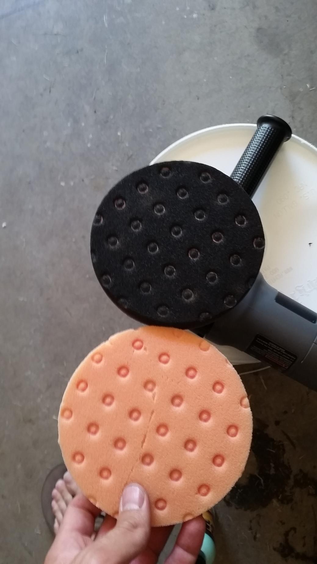

It is amazing what a good polisher and some time can do. I recently detailed my 2002 with my Porter Cable RO. The oxidation that comes off the paint is amazing, it really helps the color pop.
In the photo, the pad on top is actually orange like the pad below. The sad thing is that was only after hitting just the hood. I went through sooooo many pads that weekend... good thing I have an arsenal of detailing products.

Did the Lake Country pad just pull away from its backing plate? Wow. And to think you managed doing that just using a PC.:hail:
