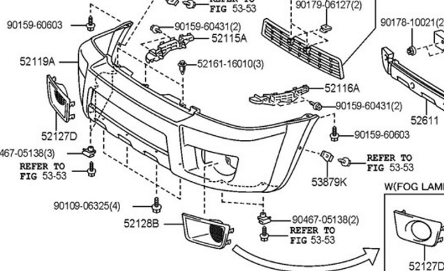

Question: does any one know what bolts screw into the bumper cover retainer clips? This is part number 53879-58010 (marked as 53879K in the attached figure).

Front bumper swap
A little off the subject, does anyone know if the bumper cover from a 06-09 4runner (PN#5211935903) will fit right on an 04 4runner? will the flares on the side match up?
