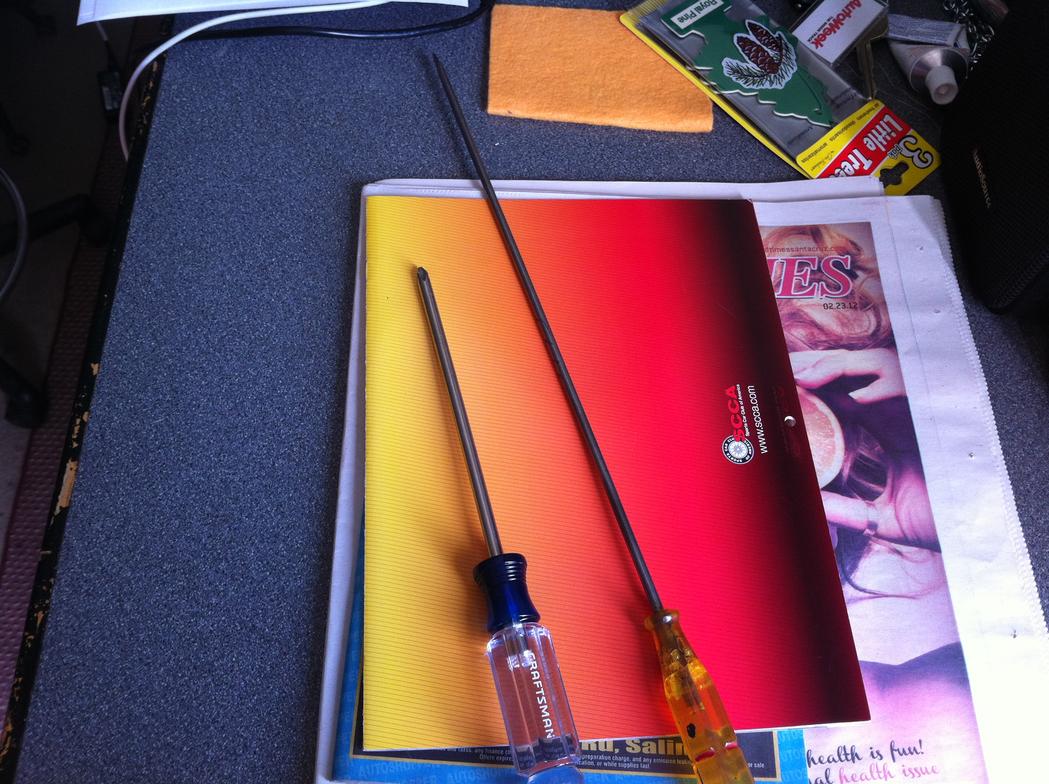

These are the only tools you need, a screw driver, and a long screw driver or something similar.

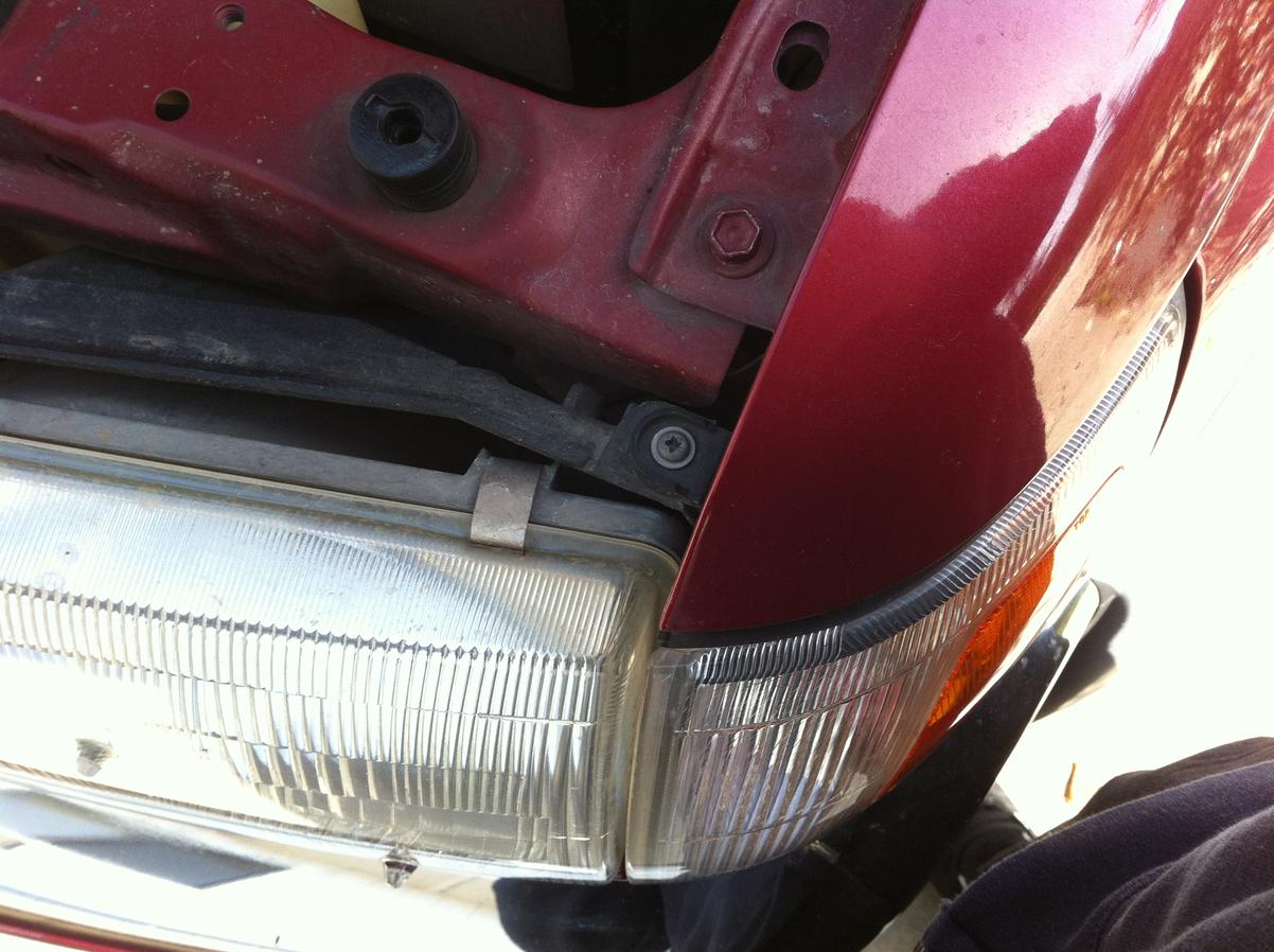

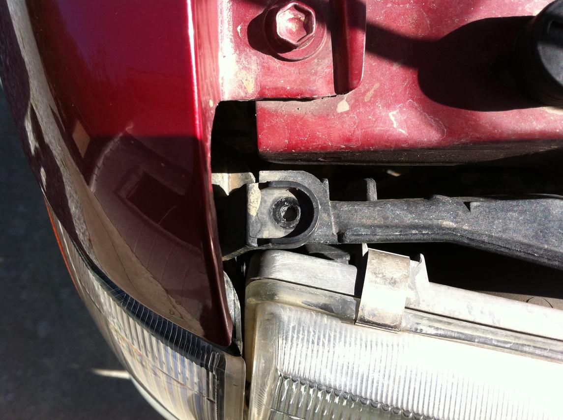

First remove the screw on top of the light next to the fender. this is the only screw that you need to remove.

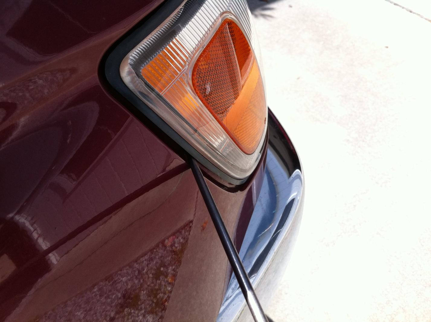

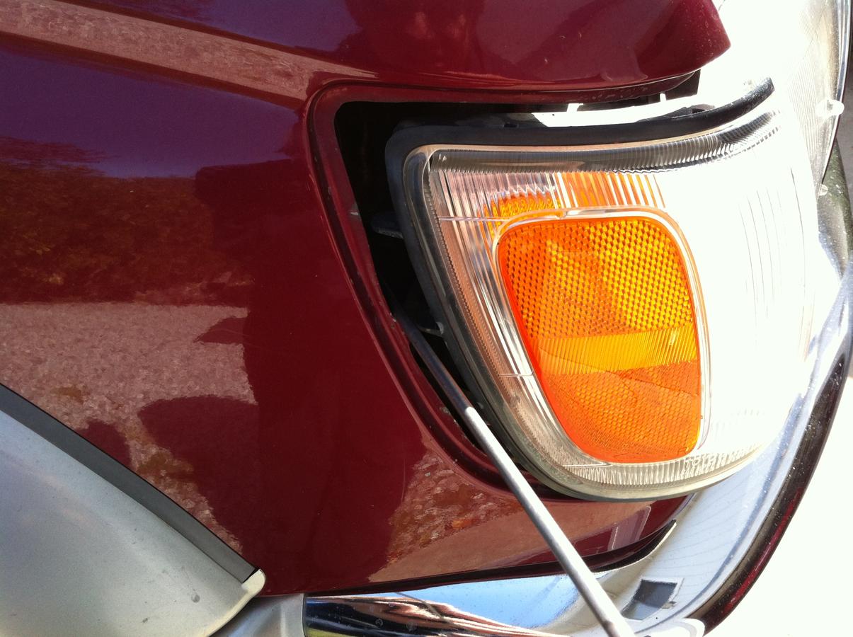

Next get your longer screw driver and wedge it between they fender and the back of the light.

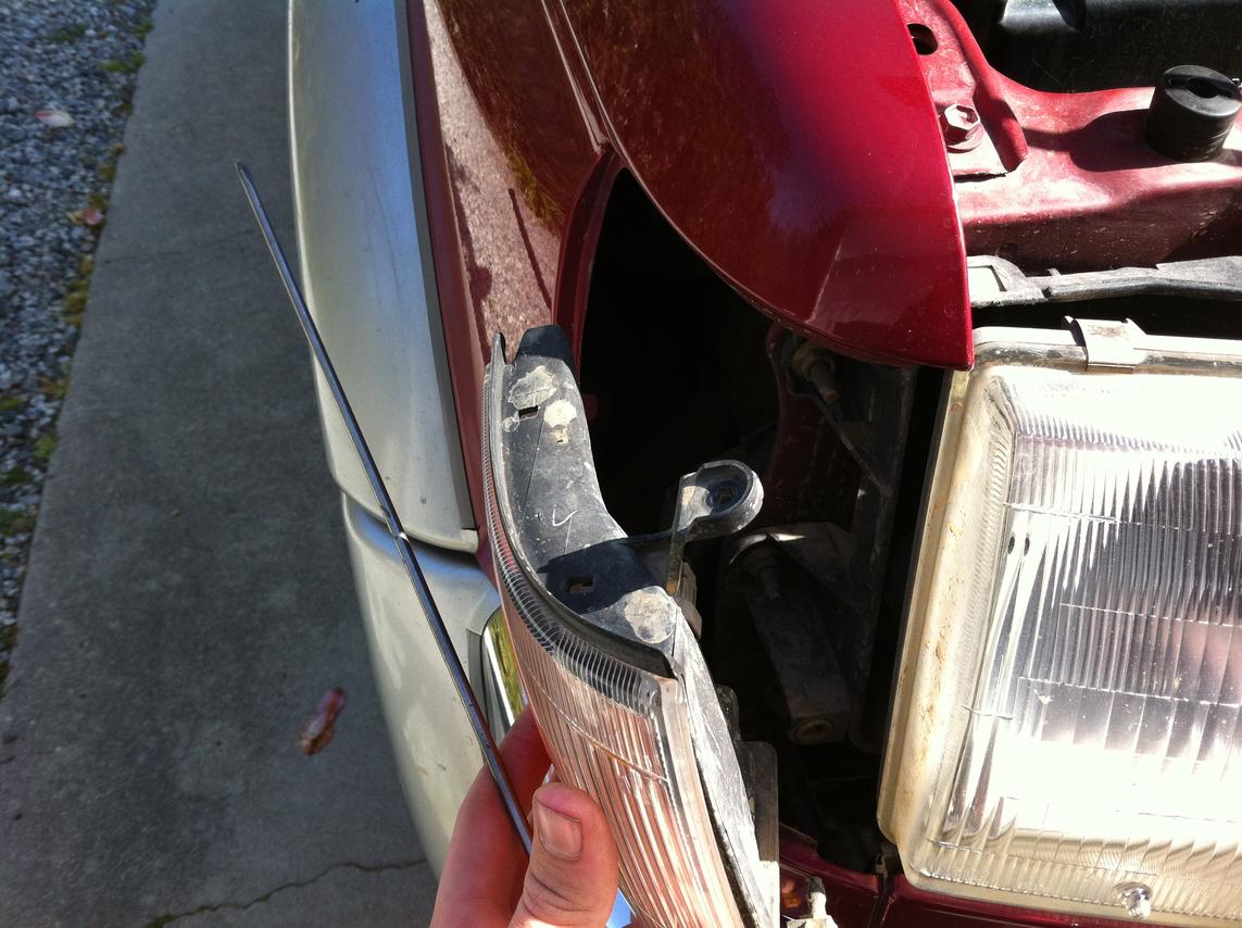

Then push your hand forward and keep the screw driver wedge between the fender and light and it should pop off.

Yea i tried the first time with my hands, but the first time is the hardest because of the tabs that hold it in, once you get it off once it is easier.
