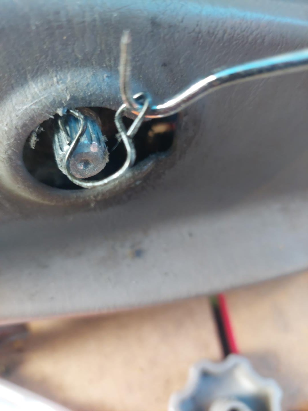

In case anyone ever needs to know - the dial to adjust the seat height on an SR5 is held on with a C-clip. I removed the 4 bolts that hold the seat down, flipped it over, and was then able to reach the clip using the hook tool seen in the photo.
For several years the dial/clip have been rattling and driving me crazy. So I finally got in there and did something about it.

1996–2002 4Runner manual seat height-adjuster knob: The knob is retained by a spring clip behind the wheel. The clip has two small ears that can be hooked with a pick through the opening in the side trim. You may not be able to see the clip clearly until it starts coming out.
