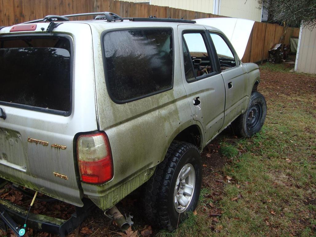

i need some info on how to remove the cladding and flairs on my limited the right way.....tips and links would be nice... i will be vinyl wrapping my rig this weekend and need them off to make the job easier. TIA
see all the holes everywhere... its gonna take a lot of bondo and sanding to fill those not to mention time

If vinyl wrap will stick to bondo then you don't have a problem. I could have all those holes filled and sanded in 2 hours. This process is going to scuff up the paint around the holes no doubt so if you ever take the vinyl off then I'd plan on truck bedlining where the flares were for cosmetic reasons. May want to paint around those areas that get scuffed up to prevent rusting.

Its going to be really hard not to break any of the clips. Just try to pull them strait out instead of at an angle. But I'd plan on having to buy a few replacements at the dealership. I think they are around $1 each. Good luck.
