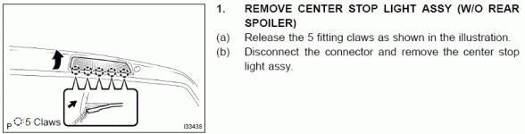

No spoiler. Sorry, forgot to add that. I know it comes out from the front, but where are the clips and do I need to cut the "gasket" or seal first? It seems like the lens will break if I proceed in trying to snap the clips.
From the 2006 manual:
