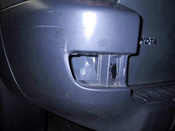

After I got home yesterday, I went over everything and found that there was no bending of the bumper (as Sac State advised). It was easy to check as the bumper lined up with the tailgate's bottom so even if it's slightly tilt it would be easy to spot. Thanks to Billf and gaslight, I removed the one 10mm nut and removed the broken reflector (whatever left of it actually). Looking closely inside the now-empty reflector housing, it's a big empty space in there and I don't believe it could cause any structural damage by hitting the plastic bumper (only if the bumper was completely crushed then the body would be damaged). I'm attaching a picture here. It actually looks worse than the picture. My 03 4Runner is only 8 months old. I was so upset.

testrider,
based on personal experience with a similar situation, this is what you should do,imo.
1. Go get 2 estimates from body shops on cost of repairs. Bring the broken reflector too.
2. After that, it looks like you can rub out most of the marks with a cleaner or polish. touch up paint the rest if you can live with that.
3. File the DMV report. It is just a one page sheet to tell the DMV the other driver is uninsured. I think you have 30 days from the accident...anyway do it, it takes 2 minutes.
4. If they don't pay. Don't stress. File with small claims and since it is a open and shut case (and you have 2 estimates to show cost) you should get a judgement right quick.
If you didn't take pictures of the other car at the accident, take a pic of their bumper too (maybe when you meet to discuss payment or get payment). Best to document that since you don't have a police report.
I'm sure looking at the picture your bumper cover just flexed from the impact. You got off lucky!
