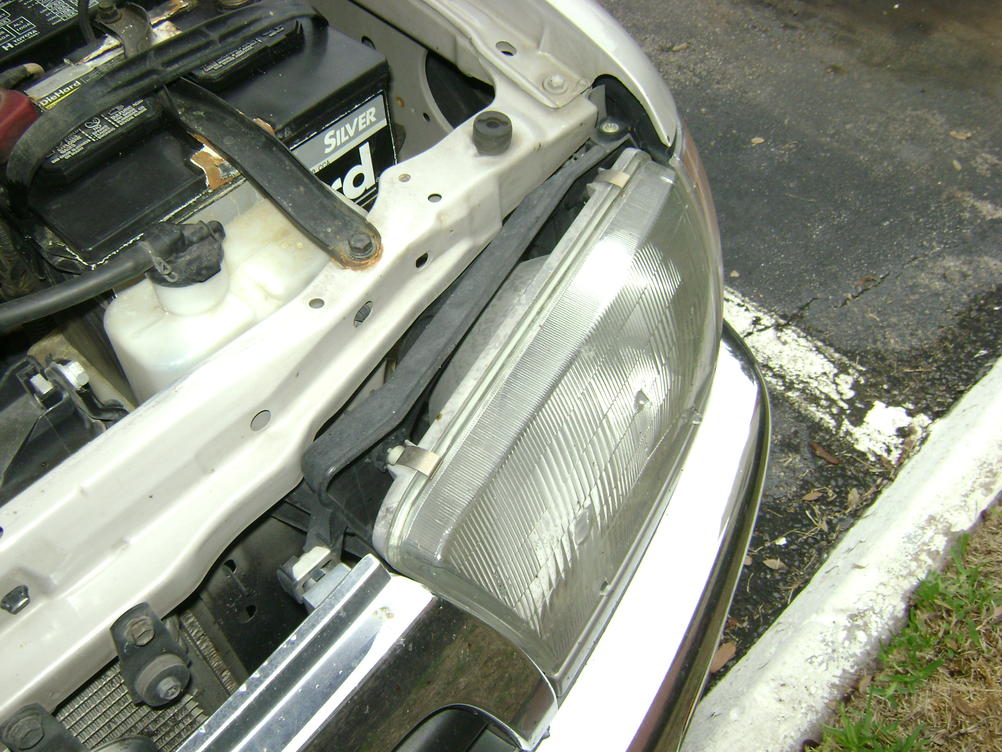

I just purchased two new replacement headlamps (mine were chipped and cracked) and was wondering what the step-by-step directions are...more specifically, does the grill need to be removed? Thanks for everyone's help.

They simply unscrew from the back. I belive there are three screws. Two of them have those plastic white gear levelers on the back. I wouldnt think you'd need to remove the grill...
Once you have the headlamp assembly removed, then the bulb just pops out along with the bushing.
hope i dont get in trouble but here is a nice how to
http://yotatech.com/f2/99-headlight-install-98-a-145621/
Wow....that person disassembled a LOT. I recently removed a bunch of that stuff (to replace parts after a wreck) and I didnt think you'd need to do all of that. I simply unscrewed those white gears that I mentioned earlier and the lamp came out...
I supposed the reason he did that was because he was also replacing the headlamp bezel (black plastic attachment)....
Elton H is correct with that link, I had to do all that because I did a projector retrofit. This is the only way to remove the headlights.
I removed my grille to get at the headlamps and pulled the entire headlamp assemblies when I did my retrofits.
Removing the filler panels under the headlamps was probably the trickiest part, otherwise it was pretty straight forward.
