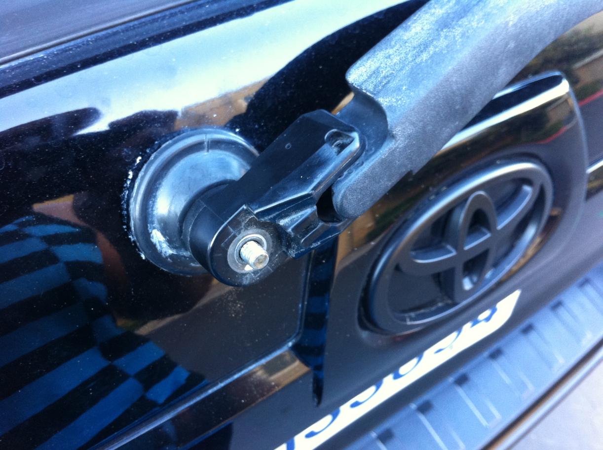

this is what im at. i took the nut off and the arm still wont come off.. is there some trick to it?

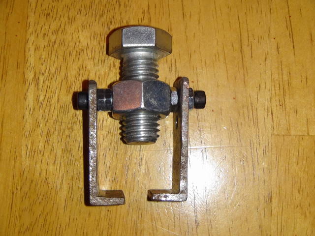

Yes. It is press fitted over the shaft. I had to make a small tool (tiny puller) to remove the thing when I was replacing the arm. Again, it just sits on the shaft, very tight though.
You need to pull the arm and push on the bolt at the same time.
If you want to wait I will try to find the tool and post pics of it when I get home.
i actually just used a clentch grip thing to clamp onto the bolt and other side and it finally popped off. thanks a lot for youre help!
