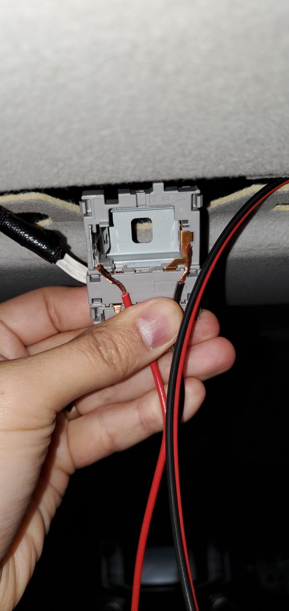

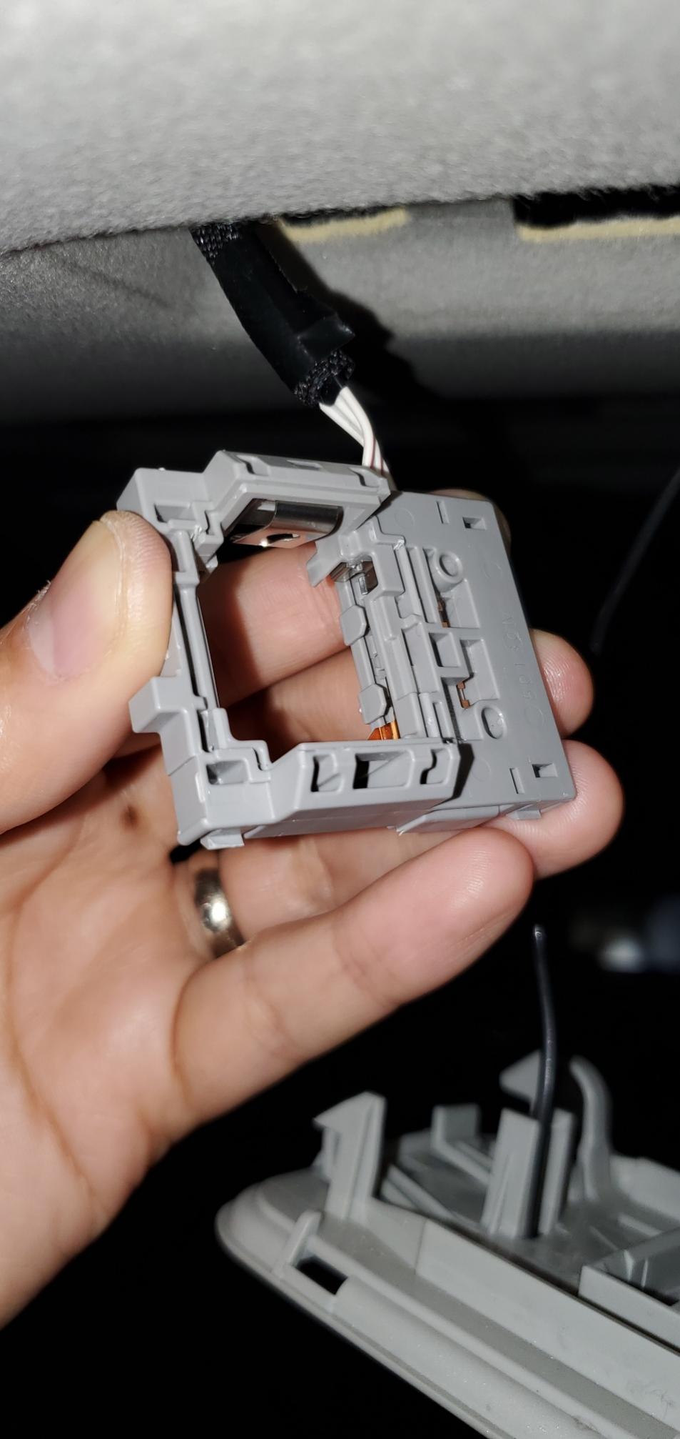

Once you remove the housing there is a small block that houses the electrical. You can pry up at 4 corners with a small screwdriver to release.

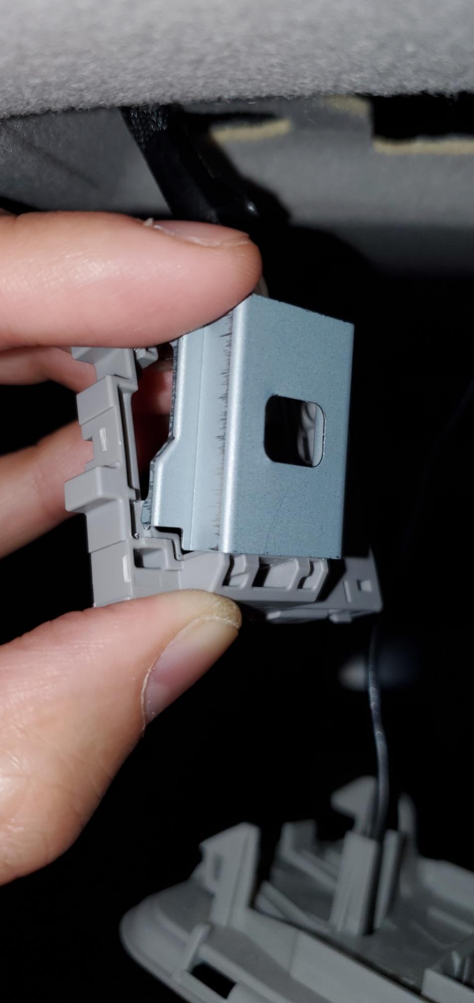

Once off, there is a metal housing/cover that simply pops off - just pry up. I left it off after as I needed the extra space for wires/terminals.

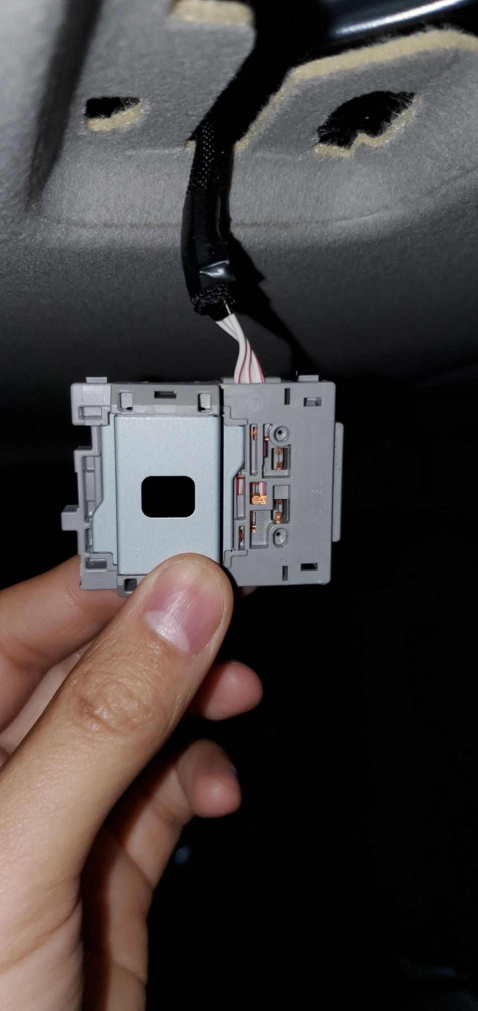

You can see with the red and black wires shown which side will give you power and which is ground. You will have to use your creativity here on how you tap/connect to these points - I will leave that up to you.

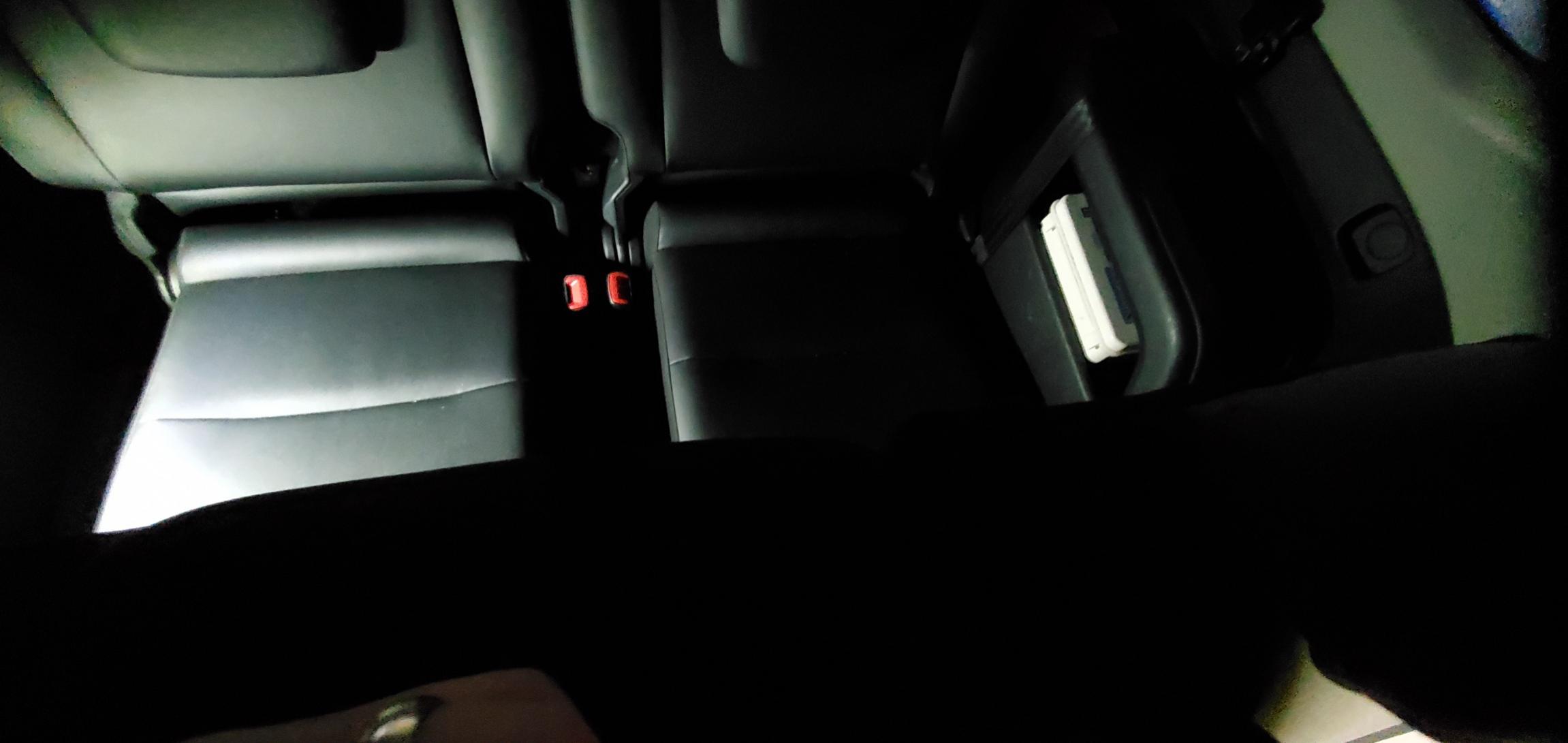

So far it works like a charm! The lights I installed even dim with the dome light!

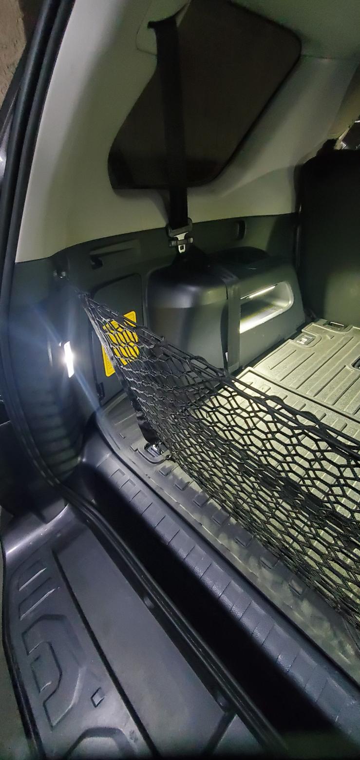

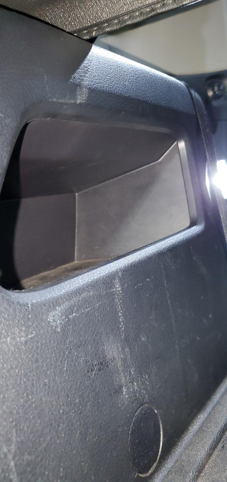

I added a strip light to the upper part of the wheel well pocket. As you can see, there is an angled portion that gives the perfect direction to aim the light. Here is a shot of the end result.

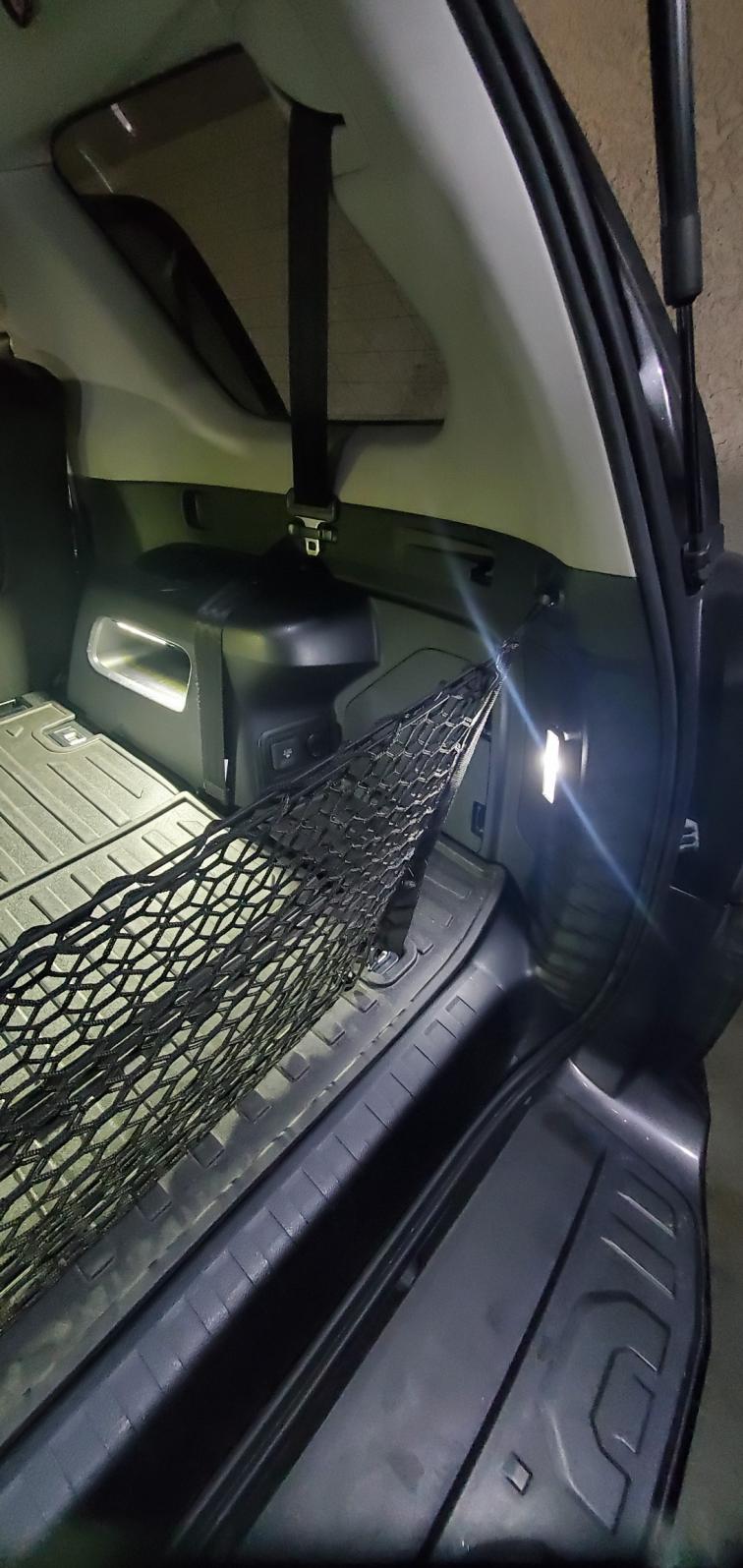

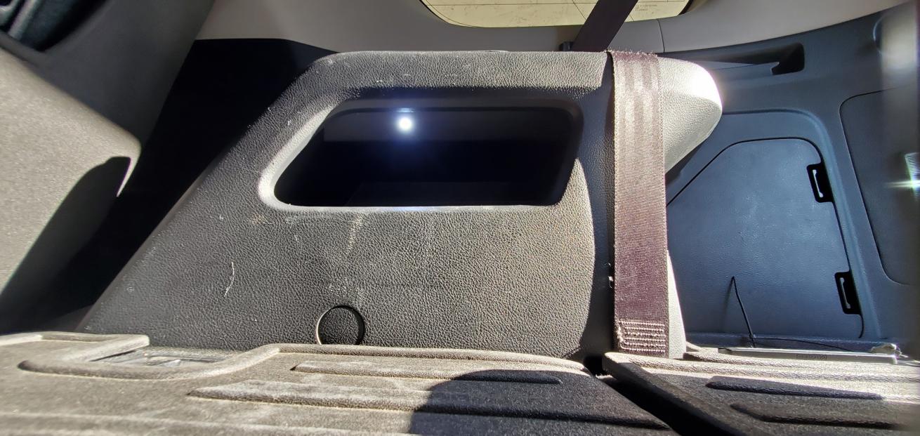

I ended up doing both sides. I might change the strip lights (6" VLEDS) to Oznium 11mm LED flush mount bolts as I don't like seeing the light source - but the lumen output is great! LED bolts won't be as bright but I like the fact that I won't see them - just the light output. We'll see!

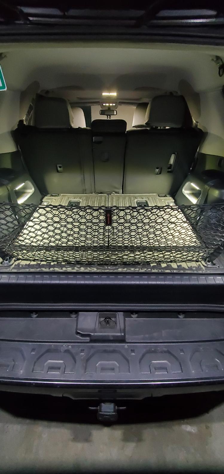

Decided to change the LED strips for LED bolts. Bit more discreet and not super bright just enough for what I need it for.
