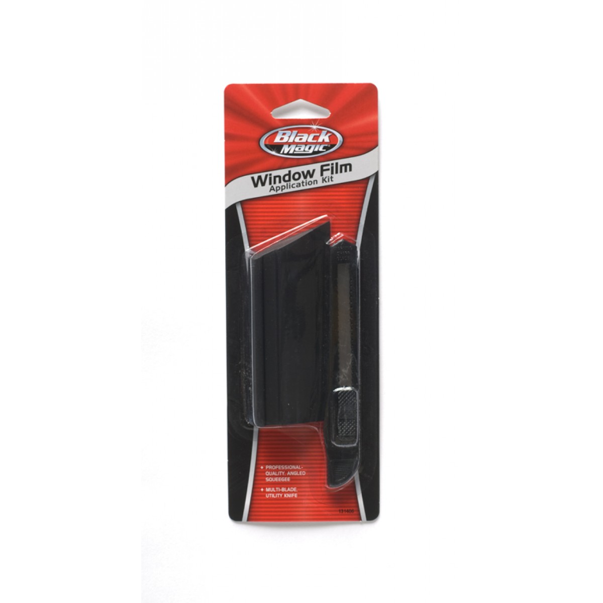

You'll need tint film, Sharp blade (box cutter), a rubber piece (I do not know what it called) You can buy it from walmart, I think it is called tint kit or something, and a spray bottle.

Now, with the rubber piece came with the tint kit, slowly press the film to the window to dissipate the soapy water between the window glass and the tint film. (film now sticks to the window). Start from the center and work outwards.
When you go to the ends (TOP and two sides, not the bottom), use the rubber piece to squeeze out the soapy water. Use the box cutter to make a clean cut at the ends.
When you are ready to cut the excess tint film from the bottom, remember to keep extra 1/2 inch to 1 inch piece to go into the door. I used a screw driver to make some space between the door panel and the window to push the tint film in. Use the rubber piece to squeeze the soapy water out.
