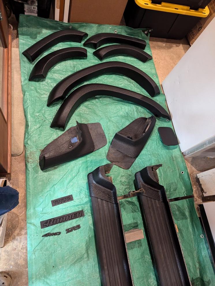

I took at stab at it this weekend. My buddy came to help sand everything down (there wasn't much clear coat left at all, but we scuffed everything nice). Anything plastic was scuffed up a ton and coated with adhesion promoter.
BT9qbz9

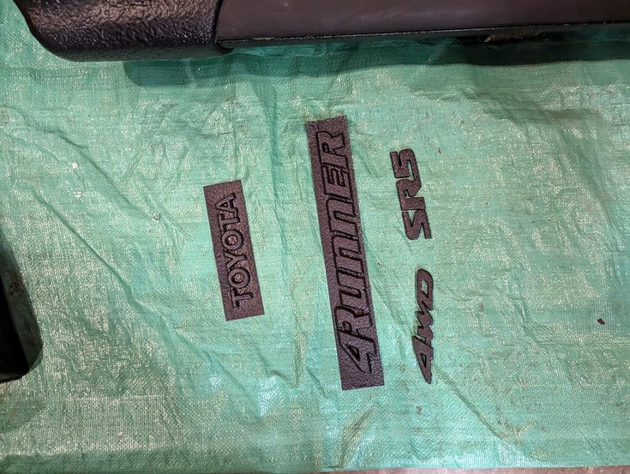

Ripped off my old emblems and bought new ones, sprayed them first then I'll mount them later with either the VHB or RTV

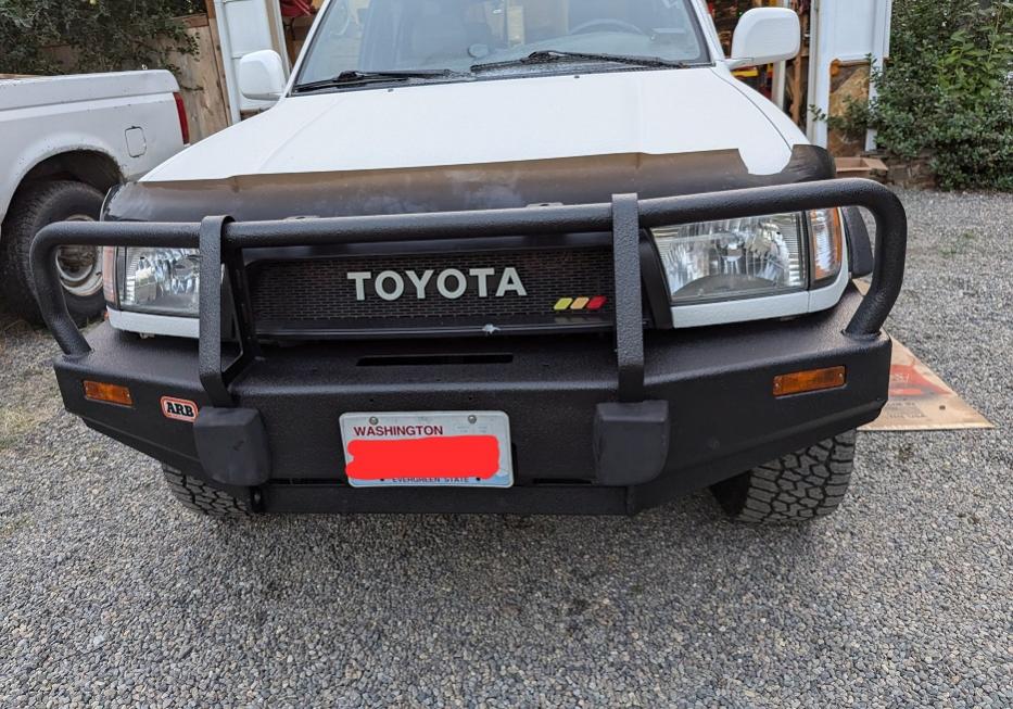

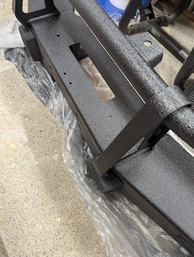

I had an ARB bumper on there and while it was already black, it wasn't "bumpy black" so I coated it to match.
y5Mpxkw

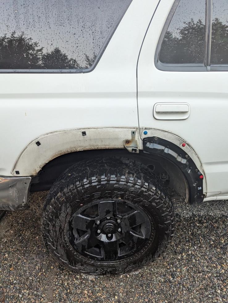

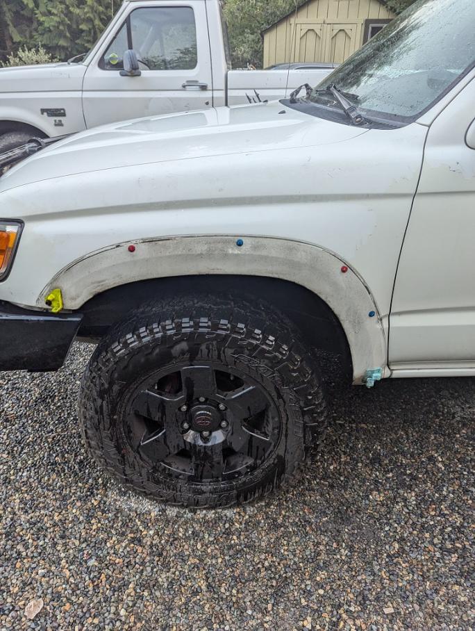

A friendly reminder for those wheel flare clips!
1T36T5q

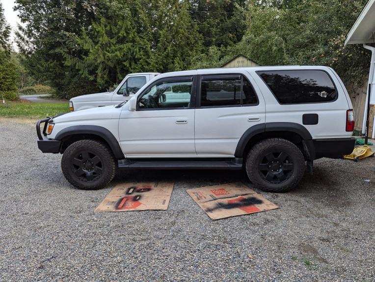

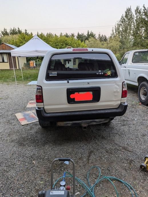

Did some bondo work on a huge dent I popped out and decided to black out the rear trim and license plate surround as well
Did the white today and reassembled everything
