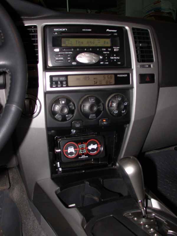

I mounted a Clinometer in mine to see what was actually going on. See just below my A/C controls. It measures 35 degrees side to side and front to back.

It's a SteelHorse clinometer that has a bracket so it swivels. I completely removed the little worthless compartment cover and hung it from the bottom of the compartment cover clip mount bar.
The cover just pulls straight up and off when it's open.
I had to shim the right side under the mount to make it level. The Steelhorse is not adjustable so the angle it faces is important or the dials don't zero out. This spot is the EXACT right angle to see it and zero the dials.
Hard to beat at $19.95. I have two Toyota JDM clinometers and they're to darn big. I like this better and it doesn't impare my view past the dash.
PS, I took the panel off and mounted it with a two screws and nuts so it would not work loose.
