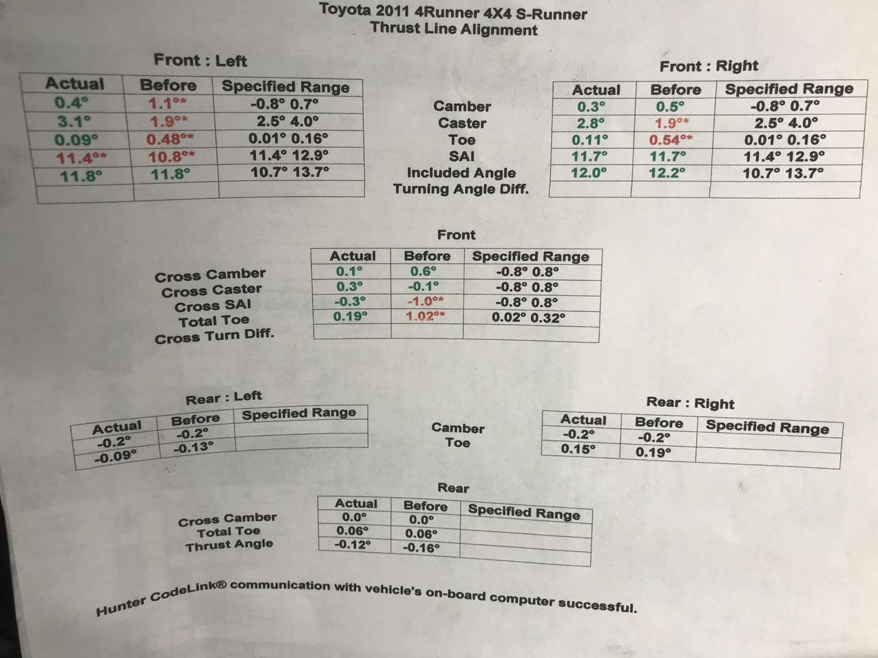

I did the FJ suspension plus spacer. Picked up right about 2” in the front. You can see my “before” alignment in the picture below. I drove about 600 miles like that before getting it aligned. No noticeable abnormal wear on my tires and it drove well enough.
I already had new tires to go on, I probably wouldn’t have done this if not, but seems there was no harm done.
