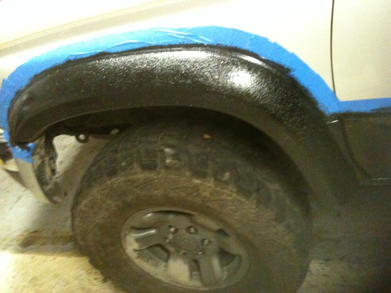

Are you stuck on "SPRY-IN"? Or would you consider roll-on like Herculiner? Much cheaper and you can do it yourself. For painted surfaces all you have to do is sand it down to get rid of the reflection then wipe down with paint thinner, carb or brake cleaner and it's ready for application. I did my fender flares and side skirts (3 coats) about a month ago and no sign of wear at all.

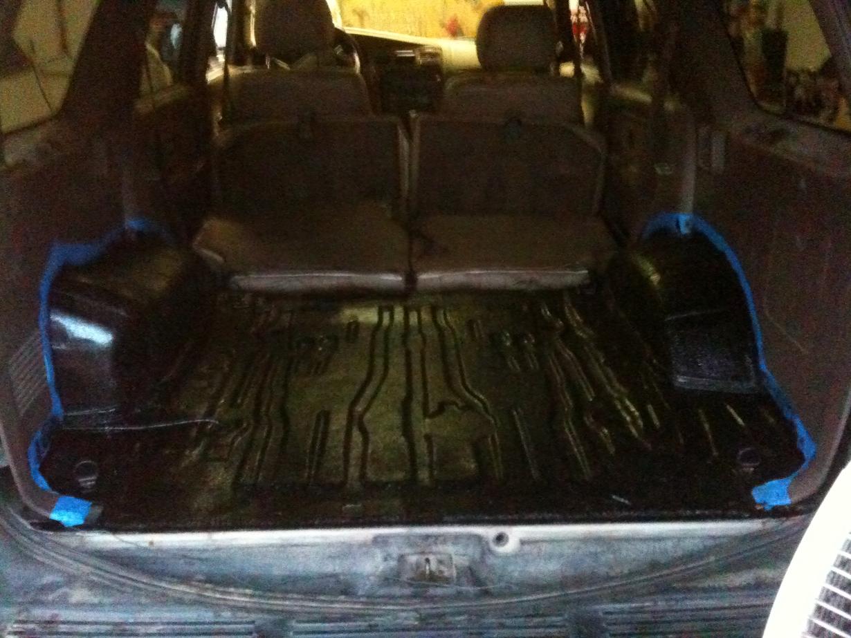

I have no idea how it would hold up to the weather. I herculined the entire interior floor of my runner and do not use a floor mat on the driver side. The liner is holding up really well so far.
