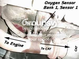

To all of you third gen owners, how did you install your wideband?

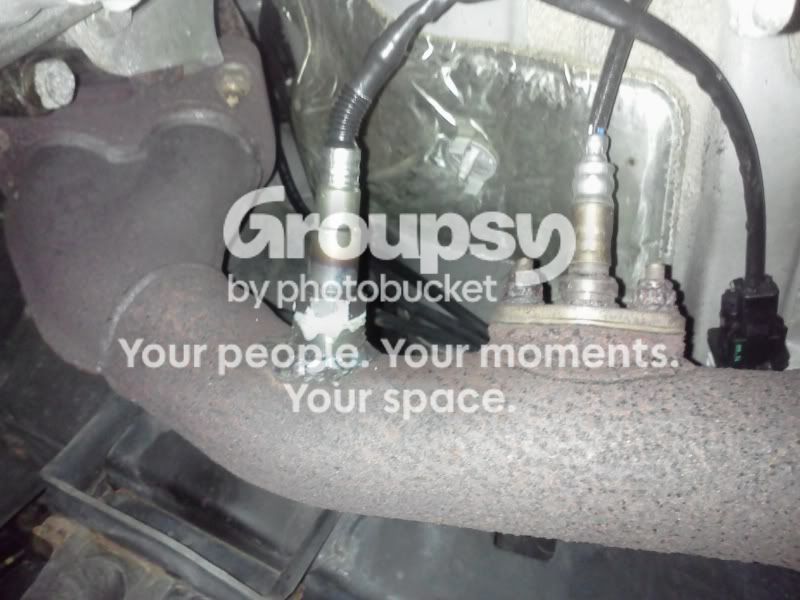

The bung in my header is made for this kind of 02 sensor.
And the wideband sensor is a screw in style like this.
You want to weld a bung in, in front of the the factory sensor. Kinda on the side of the pipe, not right on the bottom. Don't remove the factory sensor unless your ripping out your ecu and going stand alone.
That's right where this bung already is. I guess I should have made myself more clear in my first post. Basically i'm wondering if the afr sensors only come in the thread in style or do they come in the bolt-on style as well?
only threaded style. it's not hard to do though. drill a hole into the exhaust with a uni-bit until you find the right size that the bung drops into, screw in the 02 sensor and tack weld the bung in. remove the sensor and finish the weld.

One final thought... Toyota does make Air/fuel ratio sensors with that fitting. AFR sensors are just widebands. It may be possible to wire that to your wideband controller.
why are you blocking off a bung? I know you can run a signal in place of the OE sensor using your wideband controller... but you are aware that you need to keep the factory 02 installed as well, right?
I was only blocking it off because it was an extra bung.
You basically answered my question, I also thought a wideband 02 sensor would work if wired up to the wideband guage.
