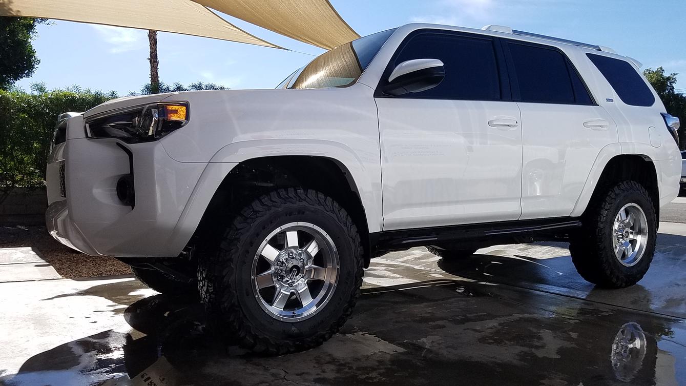

Exactly on my M-14'shttp://www.toyota-4runner.org/attachment.php?attachmentid=281088&stc=1&d=1515367137
